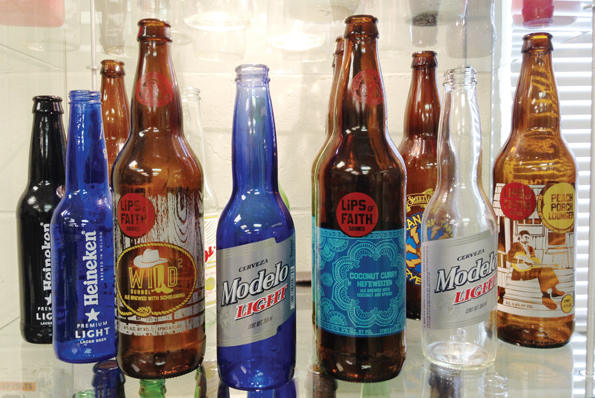

UV-curable inks and coatings can be applied and cured with different methods. The result is a variety of decorative looks. Screen printing is a method where the glass is prepared for decoration with flame and wash. The bottles are then screen printed and the ink is cured under UV light. The finished bottle has texture on areas where the screen can reach the bottle.
The electrostatic method is another application technique and is interesting because glass is an insulator. Here, a charged ink is directly sprayed onto the bottle, and then the coating is quickly cured by exposure to UV light from electrode-free lamps. Electrostatic spraying is more efficient than traditional spraying and screen printing because it coats the back of the bottle as well as the front with only one nozzle. The entire bottle can be coated, or the lip (finish) can be left unmarked. This method is a candidate for clear flint glass bottles because it economically coats with almost any color. Variable textures are also possible with UV-curable coatings.
The inks themselves create different looks. Transparent or opaque colors can be applied to create special effects that are not possible with fired-ceramic decoration. Examples of these special effects include fluorescent (day glow), phosphorescent (glow in the dark), metallic, pearlescent, thermochromic (change color when hot or cold), photochromic (change color in sunlight), glitter, scented, prismatic, or flip/flop color shift (color changes with viewing angle).
