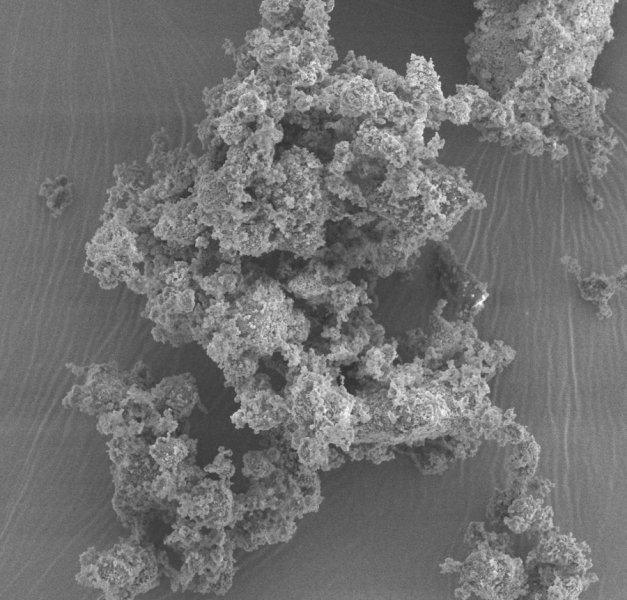

The bioactive glass BAG is incorporated in fillings in a powder form as shown in the electron microscope image Fillings with this BAG are expected to reduce secondary tooth decay in cavities
