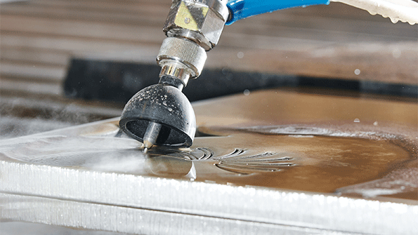

Abrasive wear can have benefits, such as water jetting. Water jetting has the ability to cut through metal with relative ease. This can reduce property changes that can occur with other processes that generate excessive heat while cutting. (Courtesy of Thinkstock)
