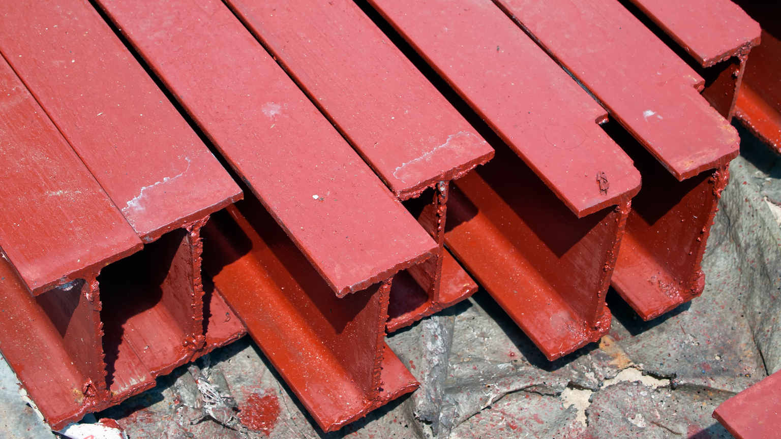

Nuttakit Sukjaroensuk/Dreamstime
Steel I-shaped beams
