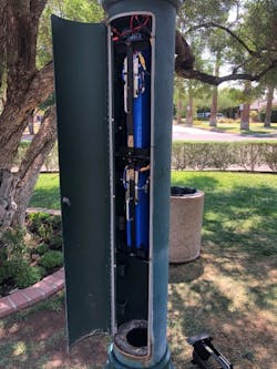

A good example of the use of the HigherWire solution is through the pilot project with the City of Phoenix. “Here at the city, we want to be supporters of circular economy entrepreneurs helping our region transition from the linear economy and keep waste out of the landfill,” said Amanda Jordan, Circular Economy project manager for the City of Phoenix.
READ MORE: A New Sodium-Ion Battery Design is Worth its Salt
Jordan is partnering with Higherwire on a pilot project to use remanufactured lithium batteries for solar panel energy storage to power lighting in South Mountain Park. The pilot kicked off on June 9, 2023 and will continue for one year. The major concern has always been the batteries’ resistance to Arizona heat. “The positive outcome of this project will pave the road to the mass usage of second-life lithium cells as energy storage for the renewables [in Arizona],” Jordan said.
This is where the story of OneCharge demo battery ends. The lithium cells used in a forklift at the fruit packaging facility ended up in the energy storage for a solar array and are expected to work reliably for another 10 years.
