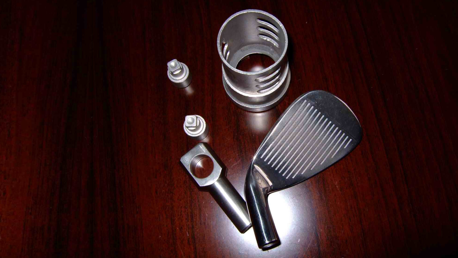

Investment casting offers several advantages over other production methods. But to make full use of the technology, designers must be aware of its limitations. Here are several tips for getting the most out of investment casting.
Shapes and Aspect Ratios
Investment casting can probably make a greater variety of shapes than any other manufacturing method. In many cases, shape complexity is almost not a factor in the finished part’s cost. If inserts such as ceramic cores and soluble waxes are not used, shape complexity becomes an expense only at the tool stage, and it would be a one-time cost. For investment-cast parts, features such as internal passages, through holes, concentric cylinders, and curved and tapered holes are as simple to cast as external forms such as bosses, flanges and shoulders. There is also no need to add draft angles because wax shrinks as it cools, making it easy to remove injection dies.
Part shape does, however, affect how parts solidify or “freeze.” Ideally, freezing should start the part’s extremities and then move back toward the gate where molten metal is poured into the mold. Therefore, gates should be placed in sections of the mold with the largest volumes.
Molten metal shrinks as it solidifies. How much it shrinks and how it affects the part’s shape is a function of the metal and the part’s design. For example, the longer the part dimension, the more the part will shrink in that direction. As a result, shrinking makes it hard to control dimensions in parts long in one direction and short (or thin) in the transverse direction. The dimensions of “stocky” parts are easier to control than those of long, slender parts. Therefore, it is wise to keep overall size ratios (either mass or dimensional) to less than 4:1. If needed, secondary sizing and straightening operations can repair parts that deform when solidifying.
RELATED: Precise Pressure and Flow Control Improve Wax Injection
Aspect ratios between sections of a part should also be considered. Ideally, investment castings are constructed like a carrot, with the thinnest sections farthest from the gate. Thin sections freeze first. So, if there’s a thin section between two thick sections and only one gate, the flow of molten metal will be interrupted and voids in the metal can form.
Unfortunately designing parts in a thickest-to-thinnest arrangement is not always practical. The design might call for tubes or chambers with relatively thin walls between thicker end sections, such as flanges or mounts. If so, follow similar aspect-ratio guidelines that apply to overall parts: Keep the mass or dimensional ratios between adjoining sections to 4:1 or less where possible. Avoid abrupt changes in section thicknesses. Make gradual transitions between them. If thin walls are necessary, consider adding short ribs to support the walls. Also, add fillet radii if possible and avoid sharp edges that can lead to tears and cracks as parts solidify.
