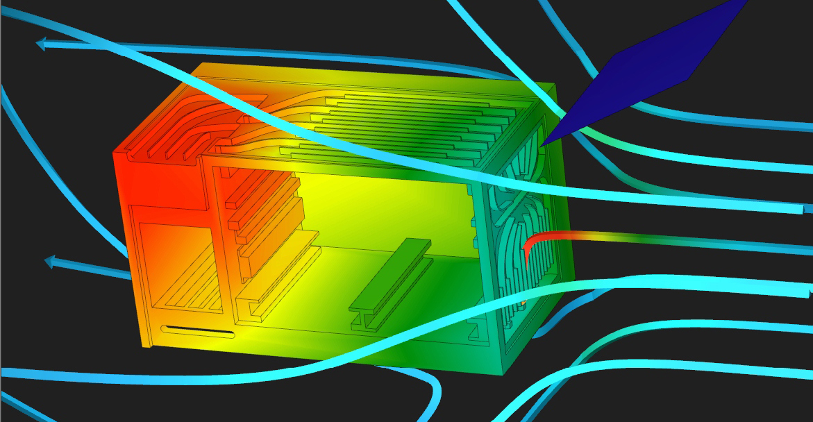

Digital tools were utilized to evaluate the thermal performance of different heatsink materials and geometries. The performance was tested within the given assembly pictured in Fig. 2, using computational fluid dynamics (CFD) to simulate the heat dissipation from an LED heat source. CFD was selected to capture the convection phenomenon by simulating the fluid surrounding the lamp. The choice and need for CFD to correctly predict this fluid behavior limits the number of assumptions needed in the simulation and enables greater precision.
The digital prototypes show the limitations of TCPs without optimizing the design, as shown in Fig. 3. When the aluminum was replaced in the original design, temperatures in the standard plastic could reach 250°C. The TCP was shown to improve the result to 150°C but far exceeded the limit.
Many concepts were developed and presented to the customer to increase the heatsink surface area for convection heat transfer and to allow for the best processability.
The new design was digitally prototyped to compare to the original design and results. The new design significantly lowered the standard plastic temperature to 175°C. What stood out the most for the new design was the TCP meeting the maximum temperature criteria, as seen in Fig. 4.
The new design was molded, tested and ultimately validated the simulation results with a 4°C temperature difference between the simulation and the real test, proving the numerical model was very predictive. The results can be seen in Fig. 5. This does not only mean that the digital solution is performing well, it also means that there is now an accurate digital twin of the test in hand, and any future changes to the digital model will be reflected in the physical prototype. With the ability to quickly iterate and understand the impact of those changes, producing many rounds of physical prototypes can be avoided, facilitating innovation and accelerating development times.
