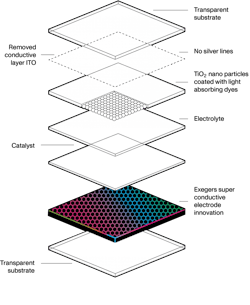

A standard solar cell (also called a photovoltaic cell) converts the energy (light) into electricity. Conventionally, they are octagonal in shape and are blue or black in color, with silver lines crossing the surface. “The silver lines are there because when a photon (light) is converted into an electron current (the power we want), it has to be transported out to the cables, so you can use the power,” explained Fili.
The conductivity in silicon or other technologies is low due to high resistance and this limits its commercial viability. “In traditional solar cells, the silver lines collect the electrons and lead them out to the cables (current collectors), so we can use it,” he added.
In contrast, Exeger’s innovation, which is branded as Powerfoyle, is an electrode nanomaterial that offers up to 1,000 times better conductivity than other materials used in flexible solar cells. Inspired by the principles of photosynthesis, the proprietary material converts any light source (inside or outside) into electrical energy, noted Lindström, who holds a Ph.D. in batteries and DSC solar cells research from Sweden’s Uppsala University, and is the first scientist to produce a solar cell on a flexible plastic substrate.
The DSC consists of a porous conductive powder layer, which was formed, for example, by screen printing a conductive powder ink containing terpineol and titanium metal powder onto a porous glass-fiber substrate. Having the electrode located directly behind the light absorbing layer is a distinguishing design feature, as it allows more light to reach the cell and more electrical current to be generated.
Screen printing was identified as the preferred manufacturing method because it facilitated the deposition of a few micrometers and up to tens of micrometer thick layers to be coated onto a variety of substrates, such as rigid, flexible or porous substrates, according to the patent report. Screen printing also happens to be an old—yet stable and cost-efficient—method of printing that allows users to print in almost any shape or design with high levels of accuracy and speed, explained Fili.
Graphics can be printed on the conductive electrode material, and Fili said it comes in more than 100 patterns and textures (such as leather, textile, brushed steel or wood) that can be produced as large homogenous surfaces, without the silver lines. The cells can be designed as large as one square meter.
