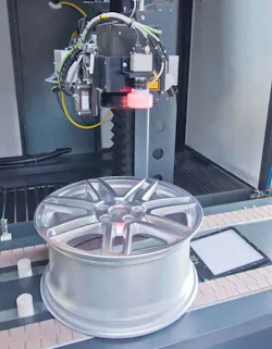

Laser structuring, texturing, marking, and engraving are typically handled by fiber lasers delivering short, sharp pulses focusable to spot sizes of 10 to 40 µm and with durations measured in nano to femto seconds (10 × 10−9 to 150 × 10−15 sec.). This means the laser delivers short intervals of high levels of power. These lasers are connected to galvanometer scanning heads (galvos), which steer the laser beam over processing areas of 110 × 110 mm using standard optics.
Although this is relatively simple for flat 2D parts, it becomes cumbersome—often impossible—on larger 3D components such as complicated automotive alloy wheels that must be marked with tiny features and intricate details over their entire surface. That’s because it requires several step-index moves and alignments to process the surface at the required resolution.
Using the conventional method just described often leaves some segments of the pattern disconnected rather than seamless. This can be fixed by using a  laser system that can wrap 2D CAD designs over 3D surfaces as large as 1,250 mm without any indexing movements of the workpiece or laser head. The process is carried out in one continuous, uninterrupted operation in which a small laser spot is used over the entire processing area. The small spot maintains the same level of resolution over the area and simplifies the production of small features. These large field removal systems, as they are called, reduce processing steps, and make it easy to process complex parts.

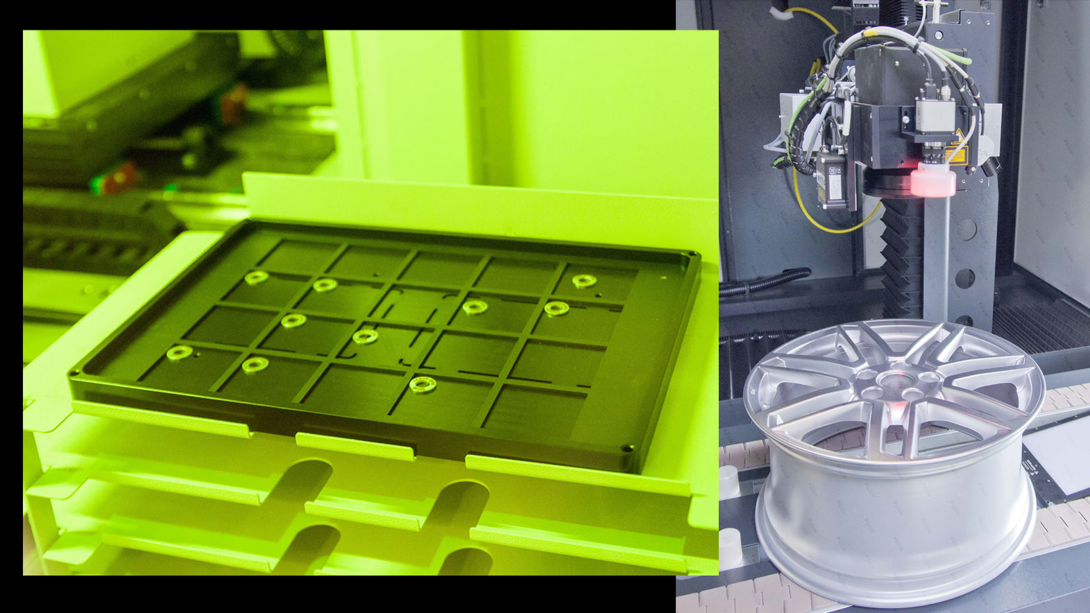

All of these questions can be resolved by using a laser-vision subsystem and automated part handling. This generally requires a high-definition camera looking down the same line of sight and optics as the laser beam or parallel to it. It also requires image-processing software that can identify a reference position on the part, such as a fiducial mark (a feature such as a hole of a particular shape) or a color contrast in certain areas. With this information and the part’s pre-programmed CAD data, the vision subsystem can determine offsets to correctly orientate parts and the laser head before processing by using either a laser galvo head, robotics, a cartesian-axis subsystem, or a combination of these.
The vision subsystem will report offsets for processing areas of interest and height and depth information about the parts. Lighting and contrast are critical to the vision subsystem’s performance on complex parts. Another set of critical factors are the positioning subsystem’s accuracy and repeatability; they ensure that laser processing starts at the right position.
