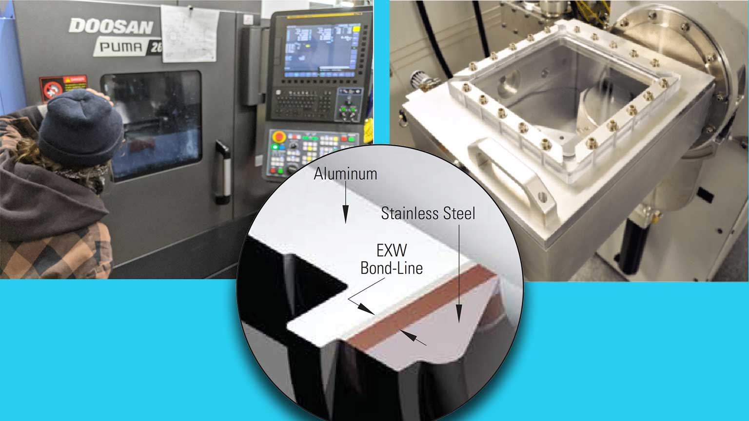

High-speed machining. Aluminum is known for its superb machinability; it lets aluminum be machined up to 10 times faster than stainless steel. It also lets aluminum chambers be made with more details. Aluminum can be cut, shaped, formed and extruded quite easily. Chamber features can be made to precisely fit an application. This can lower the need for additional space and equipment compared to the alternative of tailoring an application to fit a chamber’s limitations.

Integrating components and all-metal flange seals. When using an aluminum chamber, it is often necessary to provide a juncture between aluminum and stainless steel that will adequately seal the two together. Metallurgically bonded (explosion or diffusion bonding) bimetallic transitions provide hermetic, vacuum tight seals that handles cryogenic, liquid, or gas supply lines.
These transition joints can be entirely welded or flanged joints. Bimetal flanges provide durable, all-stainless sealing faces. Bimetallic joints let engineers choose which materials they need and where they need them to perform do their job within the overall vacuum system (see “Explosion and Diffusion Bonding,” below).
These metal-to-metal transitions withstand the pressures and temperatures needed for handling liquid nitrogen, hydrogen, helium, and other industrial gases and liquids. Adhesives are not used for these applications due to their high outgassing rates and, in cryogenics, their tendency to become brittle.

Explosion bonding or welding (EXW) is a solid-state process that joins dissimilar metals at the atomic level. Plates must lay flat against one another with a flyer plate on top of the base plate but separated by a small gap. Technicians place an explosive charge on the flyer plate and detonate one edge of it. A controlled progressive ignition travels across the flyer plate like ripples in a pond.
The explosion accelerates the plates together with impact velocities of 5,900 to 7,200 ft/sec. A high-energy surface plasma forms between the plates, moving ahead of the collision point and stripping electrons from the two bonding surfaces. The electron-hungry metals are then thrust together at extreme pressures, forming an electron-sharing bond.
Metals such as copper and stainless steel can be readily bonded through EXW. However, aluminum and stainless steel are incompatible and not directly bondable because of the explosion forms brittle intermetallic compounds
Atlas UHV has researched and developed a patented multi-layer composites technology that solves this problem. It exploits the metallurgical compatibility of a multi-layered sandwich of 316L stainless steel, copper, titanium and 6061 T6 aluminum. The fused material gives parts maximum hermeticity, ductility, and the ability to handle changes from cryogenic to high temperatures and back.
