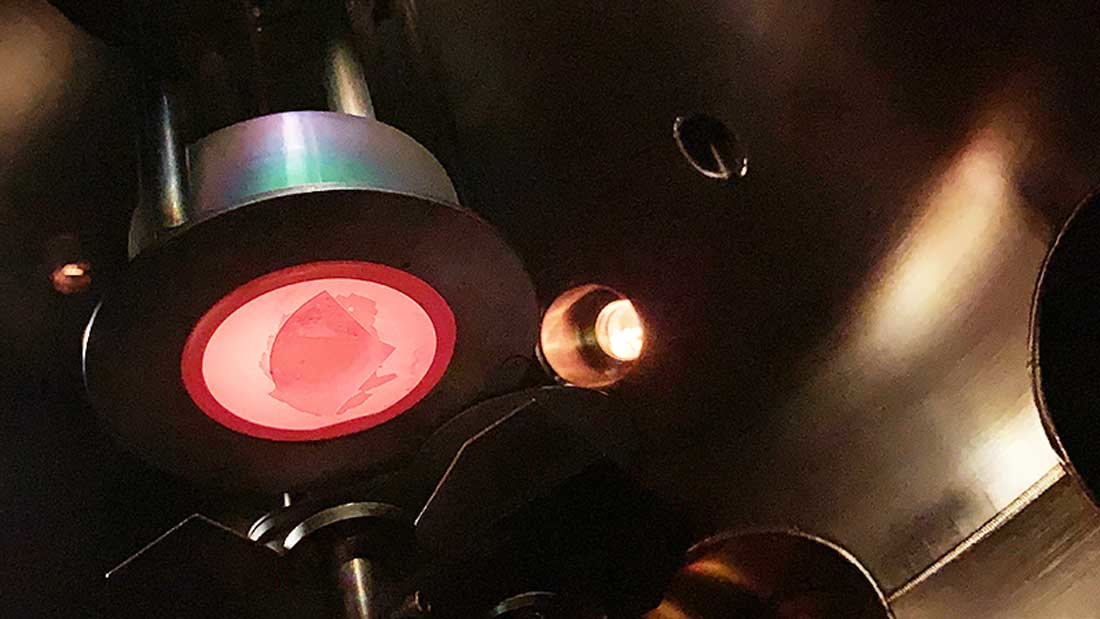

Haiyan Wang, a Purdue University materials engineer, has developed a new approach to creating epitaxial lithium niobate (LNO) thin films used for various optics, acoustics and electronics devices.
These thin films are used in the manufacturing of high-frequency and wide-band RF filters adapted for 5G infrastructures. They are frequently used in applications requiring thin films that reduce optical and acoustic losses without in-plane twin growth domains.
“We created an approach that makes these films easier to produce,” Wang said in a press release. “We developed a versatile nanocomposite-seeded approach that allows us to create single-layer films. Typically, engineers have used a double-layer approach, which adds to the complicated production process.”
The approach uses a nanocomposite buffer layer composed of LNO-Au to serve as a template for seeding the growth of untwinned LNO films. The researchers believed the inclusion of gold could reduce twin formation by “facilitating the LNO growth and nucleation and minimizing the strain-induced domain formation.”
The Au nanoparticles, temperature and the Li-rich target reduced the formation of misfit dislocation, resulting in single domain growth.
