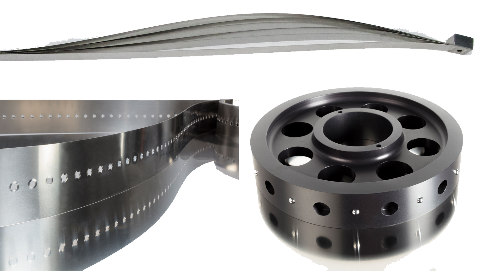

Multi-layered belts consist of 2-7 stacked bands ranging in thickness from 0.003 to 0.005 in. This minimizes the overall stress put on the belt and lets the belt carry a larger tensile load across its increased cross-sectional area. The added strength also lengthens the belts operational life.
The layered construction also adds stiffness, which increases its modulus of elasticity so the belt can resist backlash due to any remaining gaps between the timing holes and pins that cannot be engineered out. This can be helpful in many applications. For example, some robotic arms have two steel belts working in tandem with one belt driving the reversing motion. Thanks to the steel belt’s inelasticity, this design can handle rapid acceleration and reversing without causing backlash. Multi-layered belts are typically used this way to handle high loads and accelerations.
Multi-layered belts are more difficult to make due to all the layers that must be precisely manufactured and then welded together at the belt’s end tab. Each belt layer has a slightly different length and must be attached so it can fit with the other layers when wrapped around the pulley. The end tab is another key element to ensuring a long belt life because it is exposed to high levels to stress. Because of this, the design of the tab is as important as the high-quality, precision welding used to create it.

Belt thickness and pulley size determine the belt’s lifespan. A larger pulley generally means a belt can carry a larger load. But multi-layered belts can carry high load without having to increase the pulley’s diameter. The multiple levels provide the strength of a thicker band but work together to have the flexibility of a smaller band. Applications that take full advantage of multi-layer metal belts involve moving heavy loads without the space for a properly sized pulley needed for a single-layered but thicker belt. This design can accommodate pulley diameters as small as 1.5 in.
