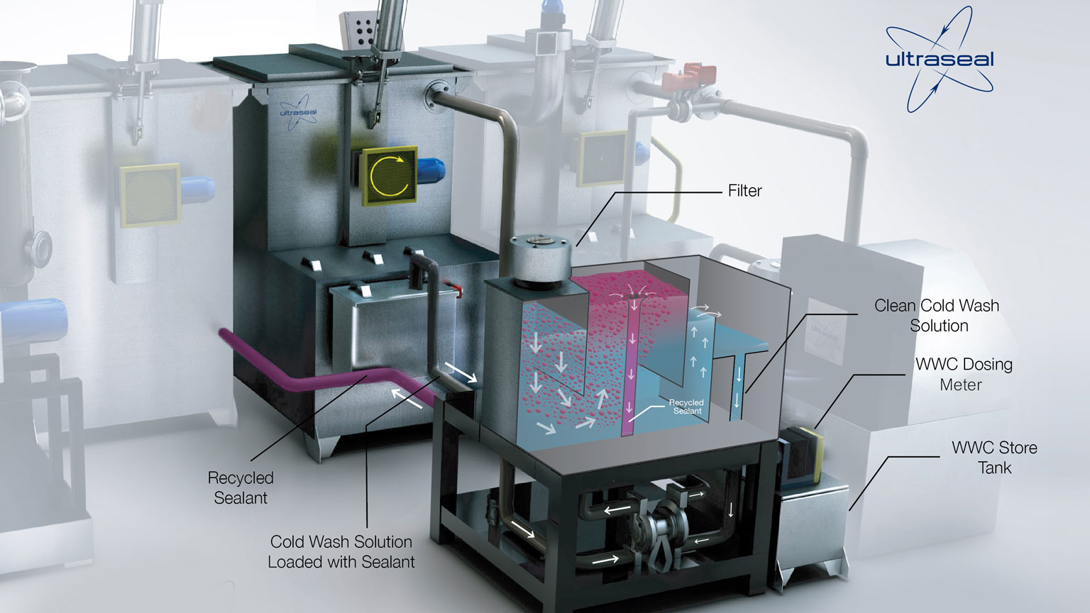

Ultraseal
Sealant recovery system from Ultraseal

In a traditional impregnation process, components are placed into an autoclave, where the component is immersed in sealant and a vacuum is used to draw the sealant into micro-porosities and leak paths. A cold wash module then removes excess sealant and a hot cure cycle exposes components to heat which polymerizes the sealant, changing it from a liquid state to solid polymer.
During the cold wash part of this process, up to 98% of the sealant used goes down the drain as waste. To overcome this expensive wastage and meet increasingly stringent environmental guidelines, Ultraseal offers a range of recyclable sealants. Instead of being washed down the drain, the sealant is collected from the wash tank and passed through a sealant recovery system for retrieval and reuse. In addition to significantly reducing sealant consumption, the process uses substantially less water and removes the need to change wash-water tanks, leading to a marked reduction in downtime while improving process efficiency.
Where customers have an incumbent supplier or have already invested in an impregnation solution, Ultraseal can convert existing systems to use Ultraseal’s recycling sealants. This helps to meet environmental regulations and reduce wastage without the need for capital expenditure on completely new systems.
