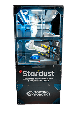

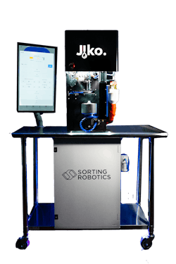

The company has developed two flagship systems: the JIKO robot and the Stardust coating system. Each is tailored to address specific challenges in this segment of cannabis manufacturing. The JIKO robot is particularly adapted for internal infusion, injecting concentrated forms of cannabis—including oils and waxes—directly into the pre-rolls. Stardust is used to externally infuse the pre-roll. This dual approach allows manufacturers to create pre-rolls with enhanced flavors and potency, he explained.

Robotic arms play a role in achieving reliable product handling. “Material manipulation is kind of the name of the game for any robotic system anywhere,” Partansky said. The JIKO robot uses a specially engineered end effector that allows for careful handling of pre-rolls to prevent contamination, which is a primary concern in cannabis production. This functionality is critical as manual processes often lead to variability and potential quality control issues, Partansky noted.
“We designed our own end effector for this application because the problem was so complicated,” he said, adding, “the end effector itself was one of the few things that we actually got right on the first try.” The engineering team drew on readily available components such as motors, bearings and gears to create an effective yet straightforward design.
One of the biggest patents that Sorting Robotics incorporated into its design is their collet pod, an essential component that addresses specific challenges in handling cannabis pre-rolls. “You need to grab only the crutch of the joint,” Partansky explained, “because you don’t want to shadow any of the places that need to get sprayed with material.
“And then you also couldn’t grab it too hard,” he continued. “You need to make sure that it’s well aligned. You need to be able to control it, and you need to be able to clean whatever mechanism you used to grab it.” He said this was a difficult set of requirements.
After some trial and error in the R&D process, the collet pod with its magnetized actuation and the use of gravity was realized. The mechanized design not only improves operational safety but also reduces contamination risks associated with traditional manual methods. By using magnetic actuation, Sorting Robotics has significantly reduced the complexity and number of moving parts in the mechanism, too. “We were able to develop a system that has two moving parts as opposed to…200 moving parts,” Partansky said.
