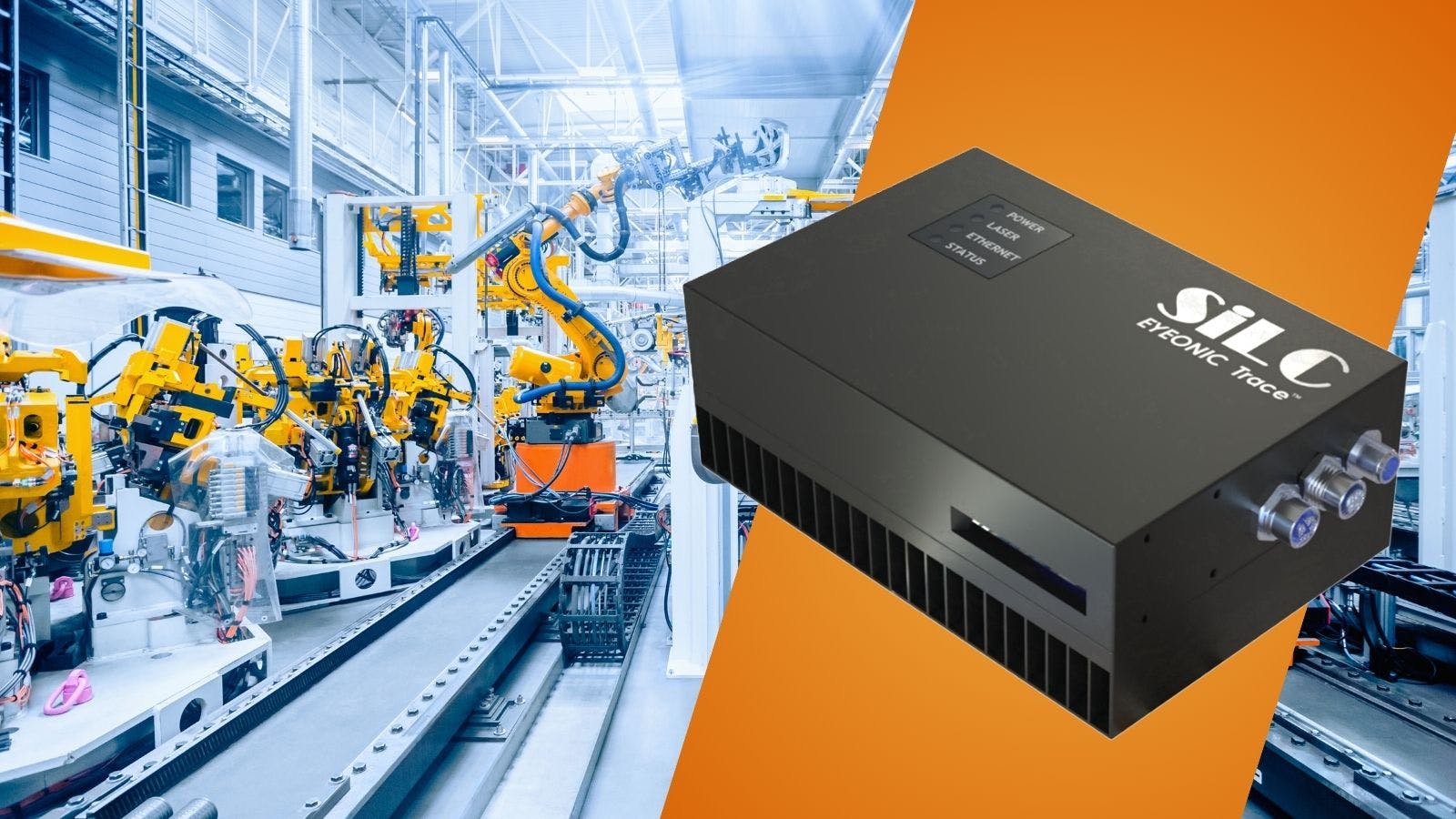

SiLC Technologies showcased its latest offering, Eyeonic Trace, an all-in-one inspection and measurement tool for objects moving on conveyor belts, bucket elevators and assembly lines or being scanned by a robotic arm.

Trace’s velocity detection accurately measures packages moving at speeds up to 4 m/sec (9 mph) —over twice as fast as many current scanners—and has an eye-safe Class 1 laser unlike most line scanners, with Class II or IIa, which can cause injury with prolonged exposure.
Key Performance Specifications of the Scanner
MD: What are the key performance specifications (including factors such as range, resolution, frame rate, etc.?)
MA: The Eyeonic Trace combines industry-leading precision, range and speed that outperforms all existing scanners. A few of Trace’s unique performance features include:
  • Exceptional range and precision. While most industrial scanners have a maximum working range of 1.5 meters, the Eyeonic Trace delivers sub-millimeter accuracy at distances up to 10 meters. This long working range allows it to scan large objects, and still capture fine details with precision as tight as 1 mm (1/25th of an inch).
  • Performs in all lighting conditions. Unlike competing systems that struggle in bright sunlight or total darkness, the Eyeonic Trace maintains full performance in any lighting. Whether scanning under harsh sun or in low light environments, the coherent receiver technology inside the Trace Scanner enables it to only “see” the light that it emits, providing reliable images in any condition.
  • High sensitivity on challenging materials. Existing sensors fail to work on hard-to-image objects, such as plastic-wrapped water bottles. The high sensitivity from chip integration and coherent detection allows Trace to easily image such objects.
  • Spatial resolution. The measurement rate of 1 million points per second is fastest in the industry. This enables extremely high spatial resolution.
  • Material identification via polarization. Trace provides reflected polarization intensity information, which enables a level of material identification.
  • Eye safety. The wavelength of light is 1,550 nm, which is eye safe (Class 1 laser).  Other scanners require warnings, training and are sometimes prohibited in some work areas. Eyeonic Trace can be used safely without training or “keep out” areas.
Addressing Scanner Response Time and Motion Blur for High-Speed Automation
MD: Scanner response time and the ability to handle motion blur are pain points when handling objects on a high-speed conveyor belt or manipulated with robotic arms. How have you addressed this shortcoming with this scanner?
MA: The Trace scans at a rate of 1 million points per second.  It measures velocity with every pixel.  Trace uses this velocity measurement to accurately dimension packages on a conveyor belt at speeds up to 4m/second. Competing scanners cannot perform this task at such high belt speeds.
