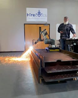

Looking at a few of today’s products, the Hirebotics cobot welding system is app-based, which provides several key benefits, says Goldiez. “People are familiar with how to use apps (scroll, swipe, touchscreens, for example), and using our app therefore presents no barrier, where the dedicated device offered by other firms can look complicated and make people hesitant,” he explains. “Also, the same app on a tablet or smartphone can be used on multiple cobots. You can just switch between them.”

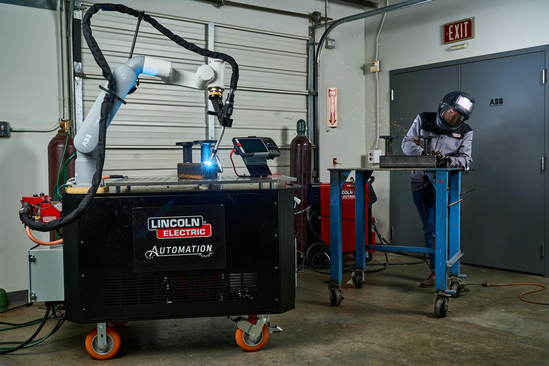

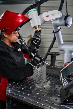

ABB Robotics, in addition to its robotic welding cells, has recently introduced several collaborative welding applications using its GoFa robot. One is an arc welding system with an interface device installed between the robot flange and the welding torch bracket. There are two buttons to record welding path positions, and a carousel menu is used to scroll through various programming instructions. The selected instruction is displayed on two screens.
The second ABB system, developed by Cooper in conjunction with Lincoln Electric, offers a teach pendant interface with a built-in welding library. The user inputs wire type, diameter, gas mixture and material thickness. The programmer only needs to record the weld start and end locations. All air moves are recorded with lead-through programming and path memorization.

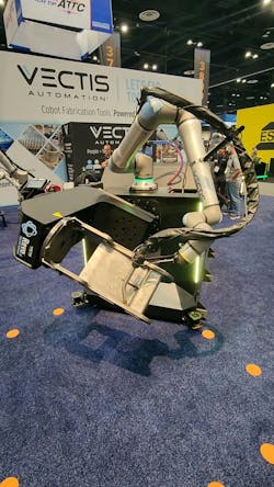

Another UR partner, Vectis Automation has a multi-axis positioning method for more complex multi-faceted parts and situations where the fabricator needs to place parts in position relative to gravity. Similarly, the multi-motion external axis solutions (including linear rails and rotary positioners) of UR partner THG Automation, also enables welding more complex parts as well as longer welds.
