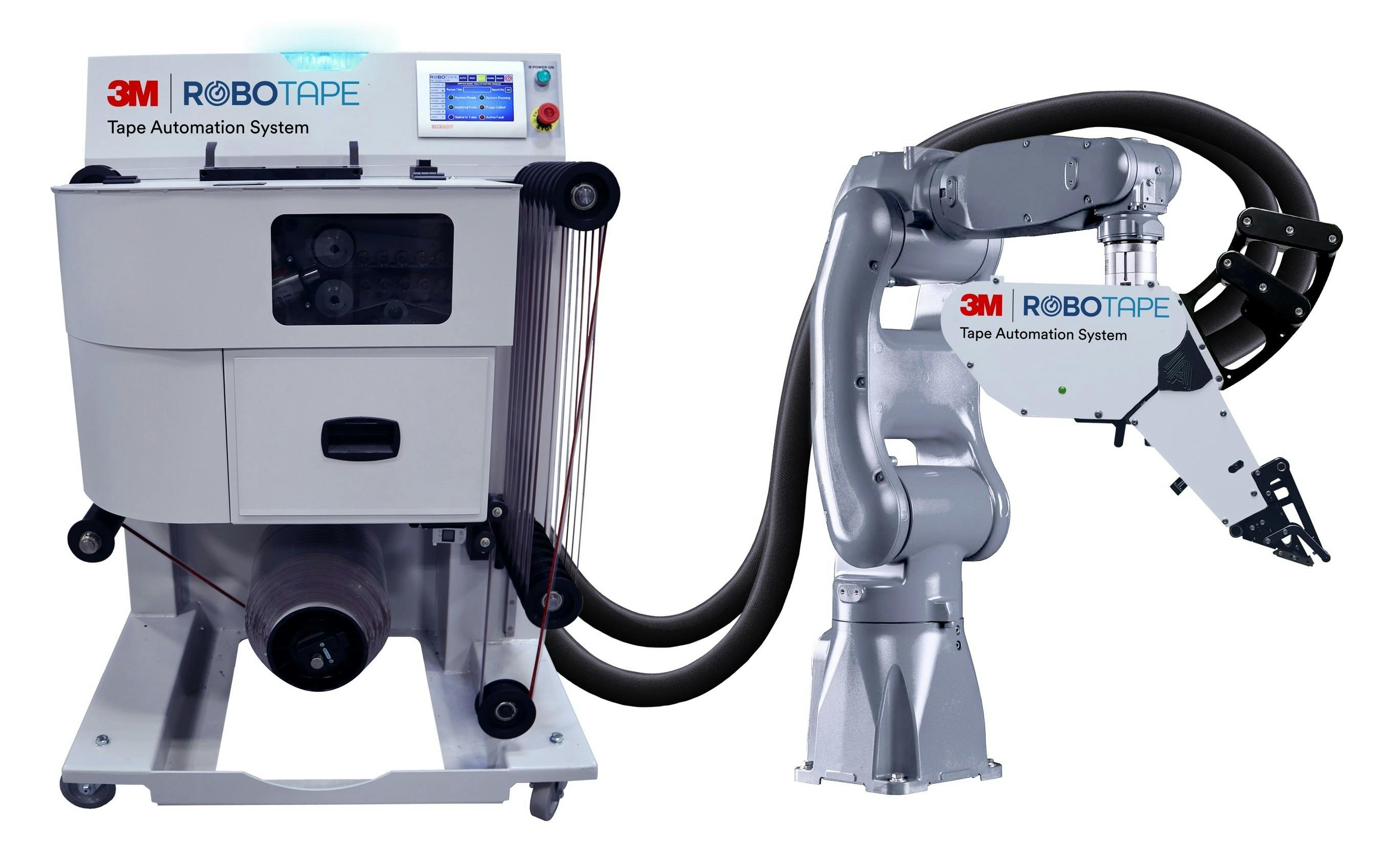

Among the robotic taping solutions, however, technologies are not one-size-fits-all. Typical systems tether the tape spool to the end of the robot arm. In the case of RoboTape, an advanced automation system designed for applying a variety of adhesive foam, the application head is attached to the robot arm, while a proprietary remote feeding system that uses bulk spools of material is positioned outside of the work cell.
“The RoboTape system consists of a head, an umbilical cord and then the payout system, explained Stephen Loftus, CEO of Innovative Automation and RoboTape. “Those systems can be about eight meters (26.2 ft) apart, which allows the product to be stationed outside your work cell and allow continuous production inside your work cell.”
The system works by using a level wound spool of tape installed on the payout or unwind stand. A lightweight application head (end effector) is mounted to a robot or cobot. The application head is programmed to peel the tape from its liner, cut the tape to length and uses pressure to attach the tape onto the receiving part or substrate. RoboTape is also equipped with an integrated wet-out attachment that ensures the adhesive makes contact with the substrate.

These features of the system support a flexible design that is compatible with small and large industrial robots and cobots, said Loftus, before reciting a list of tape options and specifications, ranging from foam, felt and attachment tapes.
“Felt tapes are used for eliminating squeaks and noises, particularly in a vehicle, and foam tapes are used for seals,” he said. “These tapes can be anywhere from 3 mm to 16 mm in width. They have to be converted onto Level 1 spool, which is similar to a spool of wire. Our system has an accumulator, which keeps product in the system so that when we run out of tape on our spool, we have time to make a spool change without impacting the production rate.”

A CP6706 economy built-in Panel PC from Beckhoff offered the required processing power for the application. The remote feeding system is equipped with a dual-core Atom processor, 4 GB RAM, 40 GB CFast card and a 1-sec. uninterruptible power supply (UPS). The IPC includes a 7-in. touchscreen for operator interface. Coupled with TwinCAT automation software, it is set up for cloud connectivity.
For real-time communication to the robot, the control system relies on EtherCAT. The openness of EtherCAT was a factor in ensuring that there would be no restrictions when integrating with a range of robots and third-party devices (such as sensors and encoders). In addition, system-integrated functional safety was achieved through TwinSAFE, triggering the remote feeding module to enter a safe state when operators open its enclosure.
