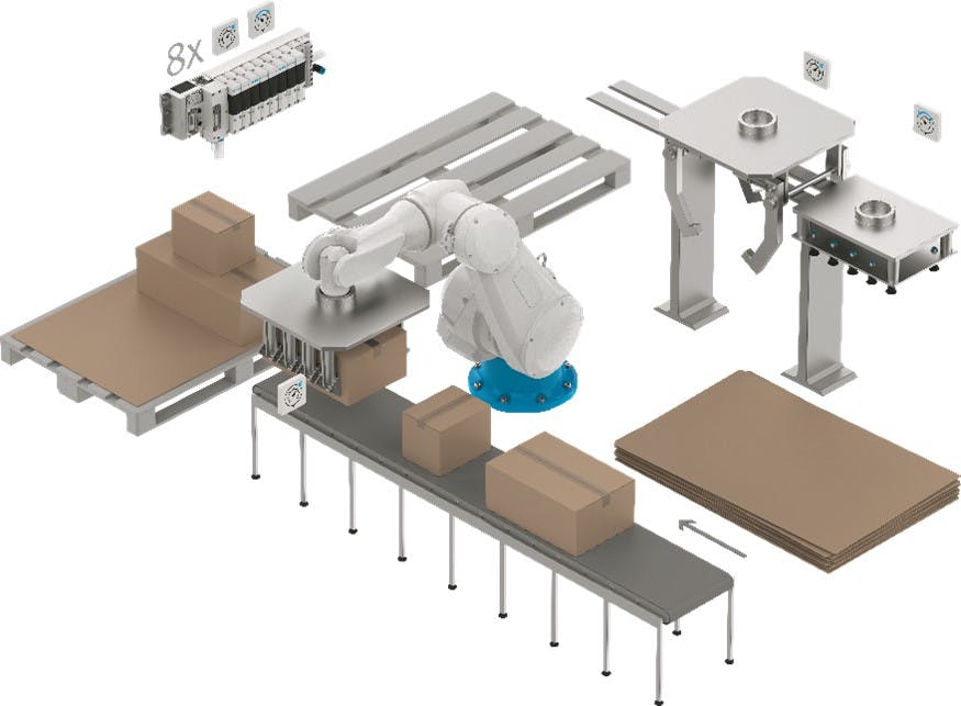

The smart pneumatic valve terminal provides positioning capabilities comparable to electric servo motors, but with the advantages of light weight and compact footprint. This is the solution used for a multifunctional end-of-arm tool.
The end-of-arm tool solution consists of the smart valve terminal and long-stroke cylinder or rack-and-pinion actuator, both integrated with analog sensors for location information. With this solution, the designer has the servo-pneumatic capability to pre-stage the position of the paddles for a faster response and change the force depending on the next package to grasp.
In addition, the controlled pneumatics valve terminal can detect leaks down to an individual cylinder, lower energy consumption by reducing pressure once the cylinder is in motion, achieve soft stop on both extend and retract, and preset travel time to ensure that despite variations in pressure, paddles open and close at the specified speed.
The smart valve terminal also controls vacuum in a pneumatic system. This simplifies the installation as one terminal located on the robot or near its base controls both vacuum and mechanical gripping on the multi-functional end-of-arm tool. The terminal can also control conventional pneumatics on the tool, such as ejector pins, giving the designer a unified control solution—one with IIoT capabilities.
