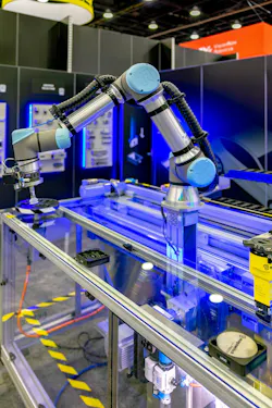

Best known for its pneumatic and electrical automation technology, Festo demonstrated its agnostic capability by integrating cobots from different manufacturers in a 7th axis application. The demo was targeted at integrators and machine builders, said Alejandro López, electric automation product manager, Festo.
Seventh-axis robots refer to robots on an electromechanical linear actuator that can move horizontally and vertically. The addition of a linear rail extends the reach of a six-axis robot.
The productivity and cost advantages of moving the robot closer to the payload are appreciable. López explained that the use of smaller six-axis robots amounts to lower acquisition costs and a more compact footprint.
The demo also showcased a multi-axis system, the Festo Motion Control Package (FMCP), which is a complete motion control panel for up to four axes motion. It comes with panel control turntables, automatic storage systems, conveyors and transfer tables.
López was able to control the end-effector or gripper with a tablet. The VPPI actuated valve was controlled via analog signal and allowed López to adjust the pressure needed to handle delicate parts. The FDA-approved gripper can handle eggs and other food items, he said, as well as glass (including lightbulbs).
