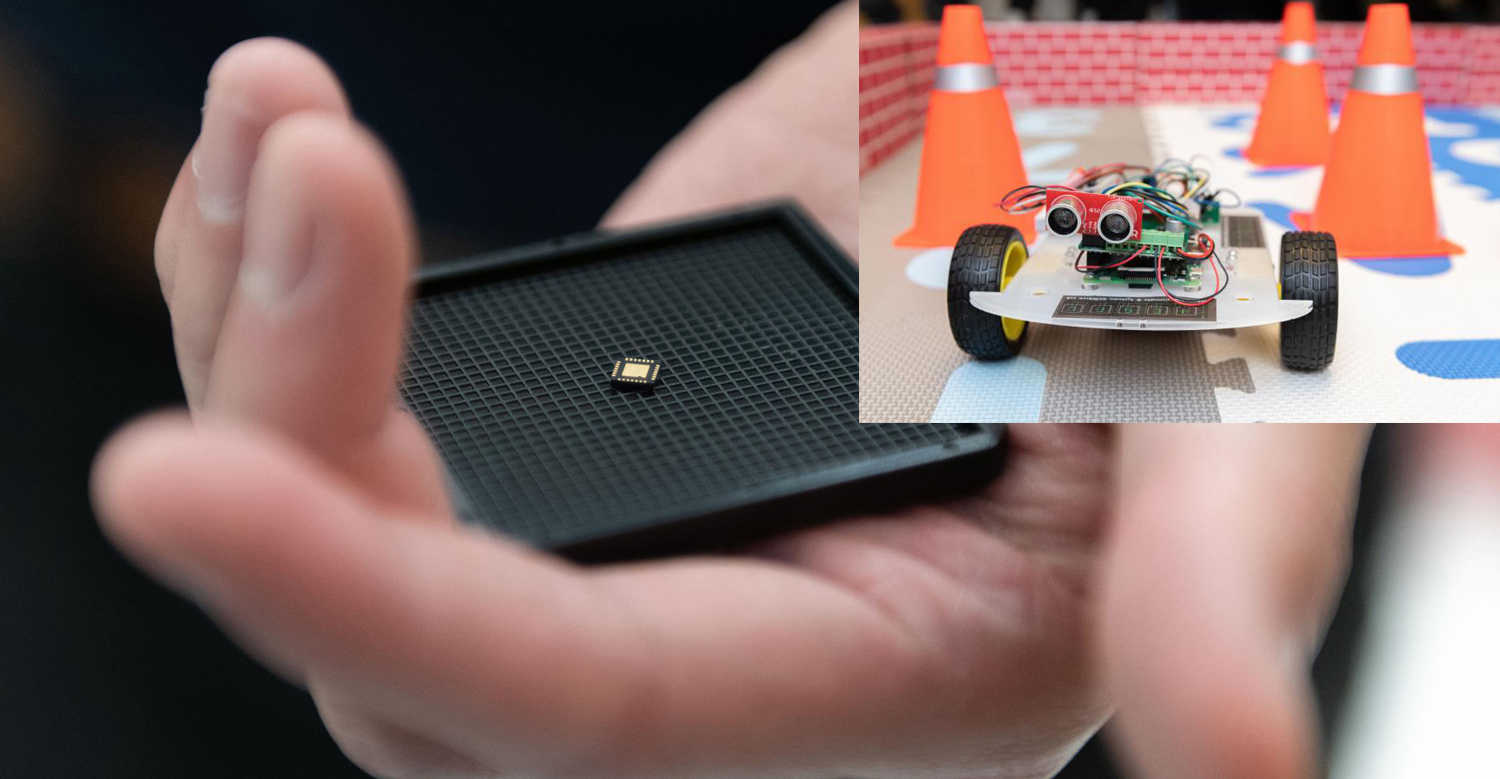

Researchers at the Georgia Institute of Technology have developed an ultra-low-power neural-network chip inspired by the brain that could let palm-sized robots collaborate and learn from their experiences. Combined with new generations of low-power motors and sensors, the new application-specific integrated circuit (ASIC), which operates on milliwatts of power, could help intelligent swarm robots operate for hours instead of minutes.
“We are trying to bring intelligence to small robots so they can learn about their environment and move around autonomously,” says Georgia Tech professor Arijit Raychowdhury. “To do that, we want to let low-power circuits in small robots make decisions on their own. There is a huge demand for small, but capable robots.”
To conserve power, the chip uses a hybrid digital-analog time-domain processor in which signals’ pulse-width encodes information. The neural network IC accommodates model-based programming and collaborative reinforcement learning, potentially giving small robots larger capabilities for reconnaissance, search-and-rescue, and other missions.

Georgia Tech researchers have developed an ultra-low power hybrid chip inspired by the brain that could help give palm-sized robots the ability to collaborate and learn from their experiences. (Photo: Allison Carter, Georgia Tech)
The 65-nanometer CMOS chips accommodate both kinds of learning appropriate for a robot. It can be programmed to follow model-based algorithms or learn from its environment using a reinforcement algorithm encourages better performance over time. It’s much like a child who learns to walk by bumping into things.

Model cars built by the researchers use the new ASIC to take information from inertial and ultrasound sensors to determine their location and detect objects around them. The ASIC is also continuously communicating with chips in other cars. The goal for the chip is to steer the car to find a target while avoiding traffic cones and other cars.
Three major subsystems consume power in each car: the motors and controllers used to drive and steer the wheels, the processor, and the sensors. Because the ASIC uses little power, the motors consume the bulk of the power. “We have been able to push the computing power down to a level where the budget is dominated by the needs of the motors,” he says.
