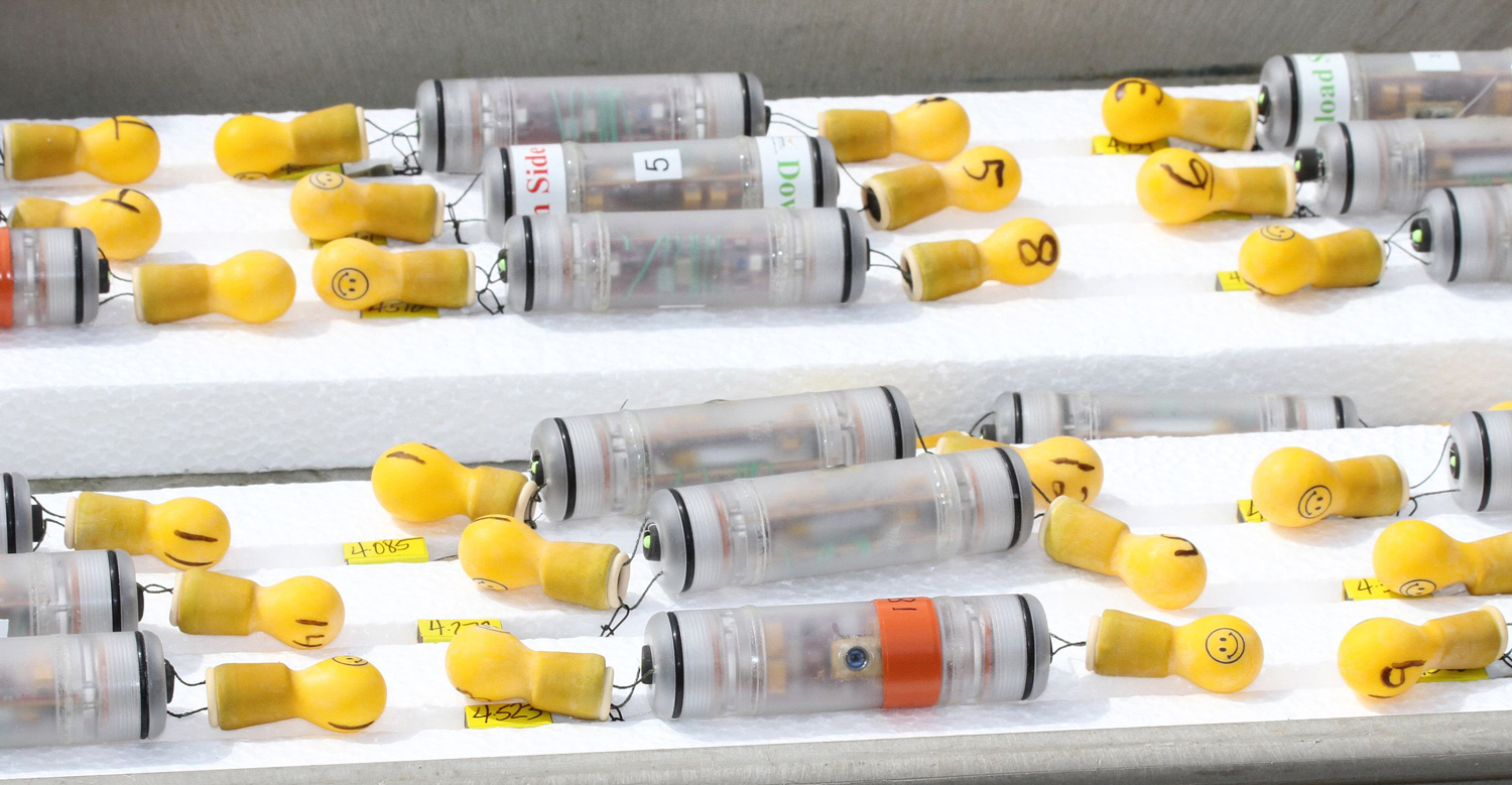

The Shish Sensor was developed at PNNL to monitor and transmit what happens to fish as they pass through turbulent waters and turbines at hydroelectric facilities. The Sensor Fish is a small autonomous device filled with sensors that analyze the physical stressors fish experience when passing through or around dams.
The sensors provide researchers with accurate physical measurements such as acceleration, pressure, rotational velocity, and orientation, all of which convey what real fish experience during downstream passages. Each sensor provides roughly 2,000 measurements per second and typically takes less than two minutes to pass through the dam due to the water’s velocity.
“The vast majority of juvenile salmon and steelhead passing through the turbines survive without injury in the Columbia River Basin,” says Daniel Deng, a laboratory fellow at PNNL. “Still, we want to understand more about the injuries and mortality that do occur from abrupt pressure changes in dam turbine chambers. The Sensor Fish will provide information to help engineers design more fish-friendly turbines going forward.”
Once the Sensor Fish comes out on the other side of the dam, an automatic retrieval feature brings it to the surface. Radio signals and flashing LEDs on the Sensor Fish enable them to be collected quickly from boats stationed nearby.
The Sensor Fish has demonstrated its value in many field studies, for which Deng’s team has built individual Sensor Fish in its lab at PNNL. Now, with the technology licensed to ATS, the manufacturing process can be streamlined so more hydropower operators and researchers will be able use them.
