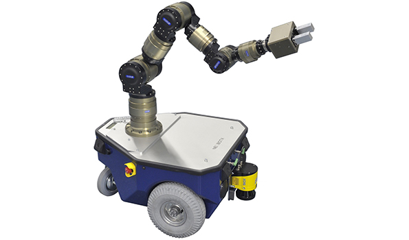

Sensing and controls is a large industry that includes collaborative robots. I was genuinely intrigued by how seamlessly some of them can operate. Teaming this technology with CNC machines and other processes frees employees for more complex tasks. They still offer the complex programming and software, but offer easy-to-use features. It might seem risky putting robots close to humans, but the collaborative robots tend to be small and not so imposing. The smaller the machine, and lower loads, means less inertia that reduces risk. This allows them to satisfy standards and regulations while fitting safely and close to employees. Furthermore, this allows a reduction or elimination of safety caging, allowing collaborative robots to fit into factories with spacing limitations.
For collaborative robots, some of the same sensing technologies are simply retooled to react to employees rather than parts; for example photo sensors, inferred indicators, and laser proximity technology. Other technologies have been adapted specifically for collaborative robots. Measuring the electrical resistance across a joint in a robot could indicate something or someone has come into contact with it, and a safety stop can be performed. A risk assessment is still important as the robot might be handling something sharp where any contact could be dangerous.
Another reinvention that is being seen in the market is Doppler technology from the 1940s. Some systems are able to detect animate objects up to 16 feet away and, unlike many other machine-vision technologies, they don’t need any light. With the ability to detect movement of about 3/4th of an inch even if a worker stops moving in a dangerous zone, the machine vision will still see them if they are breathing. Olea Sensor Networks has developed a system that is able to recognize returning scatter patterns of radio frequencies, allowing it to recognize different materials like wood, concrete, and even flesh. This is all designed for the integration of people with robots in a safe and efficient way.
