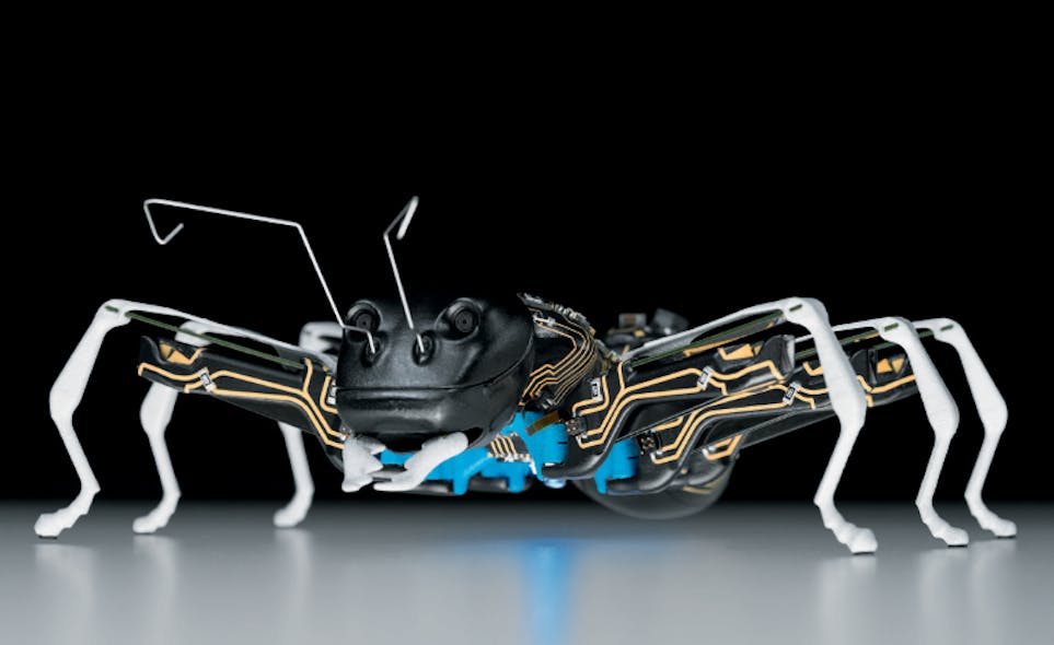

Festo’s bio-inspired BionicANTS robots, which replicate the form and function of worker ants, are the company’s latest entries into the Industry 4.0 movement and robotic revolution. They embody the main themes of swarm artificial intelligence (AI), acting autonomously while communicating and collaborating with the other ants to devise a strategy to reach a final goal. In addition, the BionicANTS feature 3D-molded interconnect device (3D MID) technology on 3D-printed structures. Festo also incorporates non-conventional use of piezo-ceramic actuators mechanically coupled with hinges for motion in miniature robotics.
External circuitry
Photo Courtesy of ©Festo AG
The legs and body of the BionicANTs are 3D-printed via selective laser sintering (SLS) with a polyamide powder. As 3D MIDs, they feature laser-etched conductive tracts for compact functionality. Festo received the 2015 MID Innovation Award from the Research Association Molded Interconnect Devices 3-D MID e.V., for its design and use of 3D MID technology on 3D-printed parts.
​Festo employs a laser-direct-structuring (LDS) machine to laser-etch the tracts and apply conductive metal coatings of gold, nickel, copper, or a mix. The external circuitry adheres to the curves of the ant’s body segments, eliminating the need for bulky wiring, since components can be directly soldered to the devices at the intended terminals. Minimal internal circuitry is needed, contributing to the compactness of the design. Read more about Festo’s 3D MID process here.

The legs and pincers employ piezo-ceramic bending transducers that are soldered to the external circuitry and coupled with hinges to enable powerful walking and grasping movements. The piezo-ceramics provide a quick response to increased voltage signals by contracting and bending for further activation of the hinge. They serve as compact local transducers for movement. In the pincer, two piezo-ceramic bending transducers mechanically induce motion of the gripping jaws. In the legs, three local piezo transducers respond to voltage signals for forward/backward and up/down motions. The ants use 8.4-V rechargeable lithium-polymer (LiPo) batteries and transformers are used to generate 300 V for piezo actuation.
