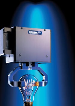

Modern robotics and their grippers (a subtype of end-of-arm tooling or end effectors) are similar to human hands in that they use integrated mechanisms and controls. Photo courtesy Schunk.

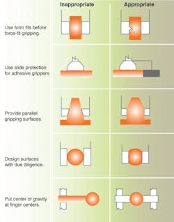

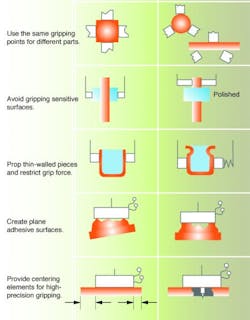

Keep it simple: Certain gripping approaches are preferred over others. Typically the least complicated grip for a given situation is recommended.
