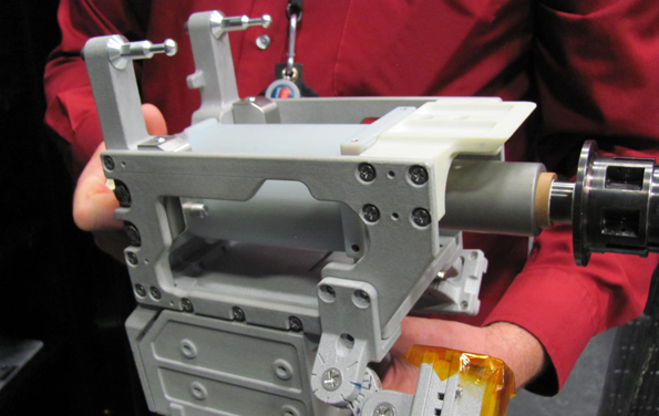

Subcomponents for the RRM module’s wire-cutting tool prototype were made with SLS. On the final RRM module, inset, the SLS tool frame is replaced with a metal version.
Engineers at NASA and the Canadian Space Agency (CSA), St. Hubert, Quebec, recently used prototypes made with selective laser sintering (SLS) to quickly test and perfect tool bodies, end effectors, and adapters for a new space module. Final versions of the tool subcomponents were then CNC machined from stainless steel or aluminum at NASA’s Goddard Space Center, Greenbelt, Md., and installed in the Robotic Refueling Mission (RRM) module.
The RRM module is the size and shape of a washing machine. Now attached to CSA’s maintenance robot Dextre on the International Space Station (ISS), it’s equipped with four tools and covered inside and out with replicas of common satellite parts and interfaces. The module’s purpose is to give Dextre a medium to prove how well robots can service and refuel satellites in orbit.
Solid Concepts Inc., Valencia, Calif., rapid-manufactured prototypes of the frames and mechanical linkages for the module’s multifunction tool, safety-cap removal tool, cutter and manipulator, and nozzle. SLS is appropriate for aerospace-grade prototypes because it makes fine-featured parts from nylon 11, nylon 12, carbon fiber, nylons with glass-bead filler (for light parts), or metals. During SLS, software mathematically slices the part’s 3D CAD file into 2D cross sections. Then the part is built in these cross sections layer by layer with a laser that selectively heats and fuses a powdered material.
For the RRM tool subcomponents, SLS prototypes were made in at least two iterations each and stiffened with aluminum filler for proof of concept prior to final manufacture. Solid Concepts also made two SLS iterations each of the four adapters that fit the RRM tools to Dextre’s arms.
