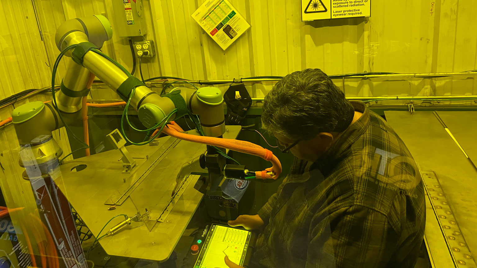

Brian Knopp: Our pre-engineered welding package is a laser welding system built around the Universal Robots UR10e collaborative robot and the IPG LightWELD handheld laser. We have a standardized welding table designed with integral robot mounting brackets, storage for the UR controller and, most importantly, mechanical and pneumatic fixturing. We have designed an EOAT (end-of-arm tooling) system to mount the welder to the cobot and developed a URCaps software application that enables the robot program to dynamically set and adjust welding parameters and select between spot welds and path welds. The system also includes an enclosure with safety interlocks.
