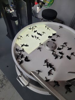

In a recent solution Skye Automation was tasked with configuring an end-to-end automated bowl feeder solution that could perform dimensional and quality inspections on a range of components for an automotive component supplier (Tier 2).
“The challenge was feeding,” explained Gorter. “Parts neither fed well through a traditional vibratory bowl, nor did [the client] have the high volumes to justify a vibratory bowl—because that would need a dedicated machine. So, we developed a specific application around the FlexiBowl that could feed various components into a standard inspection station and where we could do a dimensional check on the parts.”
Circular System
Unlike a vibratory feeder, a FlexiBowl is a flexible bulk feeder that consists of a rotating plate that relies on the combined actuation of a servomotor and a pulse generator to separate and feed parts. The patented brainchild of ARS Automation, an Italian supplier of automation systems, the bowl feeder is compatible with robots and vision systems and is suitable for facilities that have reduced volumes and frequent product changeovers and for applications where parts don’t feed well through a vibratory bowl. The FlexiBowl’s achieved feed rate is between 20 and 50 parts per minute and has a high payload, with parts total weight exceeding 7 kg, according to ARS Automation.
“The Flexibowl only ever becomes a component of the overall system,” explained Gorter, who co-founded his company with his wife, Rachel, in 2015. The company provided a way to channel Gorter’s machine vision integration experience and evolved to a machine design and build operation.
Drop, Separate, Pick, Recirculate
In a typical parts feeder scenario, a hopper drops parts onto the surface of a circular feeding bowl, which uses the principles of bidirectional rotation and an impulse generator to separate and stabilize parts. A vision system (camera) takes a photograph of the components before an algorithm identifies the location of the objects on the disc. These coordinates are relayed via communication ports (actuated via Ethernet or I/O) to a robot for the pick and place sequence.
Gorter pointed out that there is a trade off in the feed rate (it is “a little bit slower”) relative to a traditional vibratory bowl, but the added flexibility, by having one machine that’s capable of doing many different tasks, makes up for what it lacks in terms of speed rate. Skye Automation’s client was looking for a feeder system that could handle six different families of components, with a cycle rate of 10 PPM and with dimensional inspection functionality that could ensure components had been formed correctly before being picked and placed.
Alongside these specifications, their needs assessment revealed the design team would have to develop an automatic tool changer at the robot end, with a nest for component inspection. At the vision integration end, cameras oriented in two different directions would inspect parts with a high degree of repeatability and accuracy. “We’re running at about 50 microns for repeatability and dimensional accuracy,” said Gorter.

For the flexible feeder system to work as intended, the vision system had to be calibrated to the robot. The vision software is not proprietary, but it is a standalone product for which Skye Automation has secured exclusivity in North America. The software, which Gorter’s team paired with GigE cameras, runs on a Windows IoT computer.
“The components are generic; we simply program the vision using pre-made tools that are designed for advanced machine vision functions,” said Gorter. “Additional capabilities are possible through scripting custom tools in MvTec’s HALCON software and adding them in for more specialized applications.”
From there, the team used industrial communications from the PC to the industrial components, which is typically Ethernet IP to the robot, and Ethernet IP to the FlexiBowl. The software interface becomes the master controller for the integration and communication between devices, said Gorter. Overall, his team was able to achieve a robust solution with a high degree of precision and reliability for the long term.
