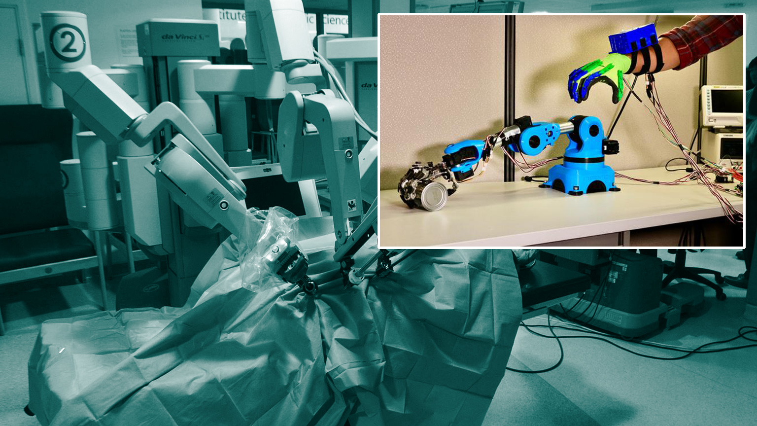

A novel technique developed by researchers at Texas A&M University demonstrates that it is possible to minimize errors when small, perceptible buzzes of electrical currents are delivered to the surgeon’s fingertips. The currents provide an accurate perception of distance to contact and enables users to control their robotic fingers with greater precision as they target fragile surfaces.
At the Fingertips
Telerobotic surgical systems are physical extensions of a surgeon. Robotic end effectors, or grippers resembling human fingers, are the direct interface between the robot and the part that it’s handling. The grippers are designed as an extension of the teleoperators’ fingertips, so they provide enhanced intuitiveness and control accuracy. By controlling robotic fingers with movements of their own fingers, surgeons can perform intricate procedures remotely.
In a video demonstration, Hangue Park, assistant professor in Texas A&M’s Department of Electrical and Computer Engineering, compared the challenge of performing surgery using a telerobotic system to threading a needle while looking at one’s hands reflected in a mirror. While possible, Park acknowledged, it is much harder to accomplish. Surgeons look at a monitor to match their own finger movements with those of the robot. But they are unable to tell the precise distance from their contact point, which can be only roughly ascertained through visual feedback.
“With our design, surgeons will be able to get an intuitive sense of how far their robotic fingers are from contact—information they can then use to touch fragile structures with just the right amount of force,” said Park.
However, visual information is not enough to guide fine finger movements, a critical aspect when the fingers are in close proximity to the brain or other delicate tissue.
“Surgeons can only know how far apart their actual fingers are from each other indirectly—that is, by looking at where their robotic fingers are relative to each other on a monitor,” Park said. “This roundabout view diminishes their sense of how far apart their actual fingers are from each other, which then affects how they control their robotic fingers.”
Park and his team proposed an alternate way to deliver distance information that is also independent of visual feedback. By passing different frequencies of electrical currents on the fingertips, they were able to train users to associate the frequency of the pulsing sensation with distance. Increasing current indicated that they were closing the distance between the fingers and the target area. The researchers compared the performance of users receiving current stimulation along with visual information from the monitors to those who received visual stimulation alone.
In addition, the researchers calibrated their technology to the user’s sensitivity to electrical current frequencies. If a user was sensitive to a wider range of current frequencies, they noted, the distance information was delivered with smaller increments of increasing currents to maximize the accuracy of proximity estimation.
Findings
The research, reported in  the journal Scientific Reports, showed that teleoperators receiving electrical pulses were more aware of the proximity to underlying surfaces and could lower their force of contact by about 70%. Overall, they performed much better than the group that was not equipped with the technology.
Proximity information delivered through mild electric pulses was about three times more effective than the visual information alone, noted the researchers. They also found that neither adding the proximity sensation nor visual assistance increased approach time.
