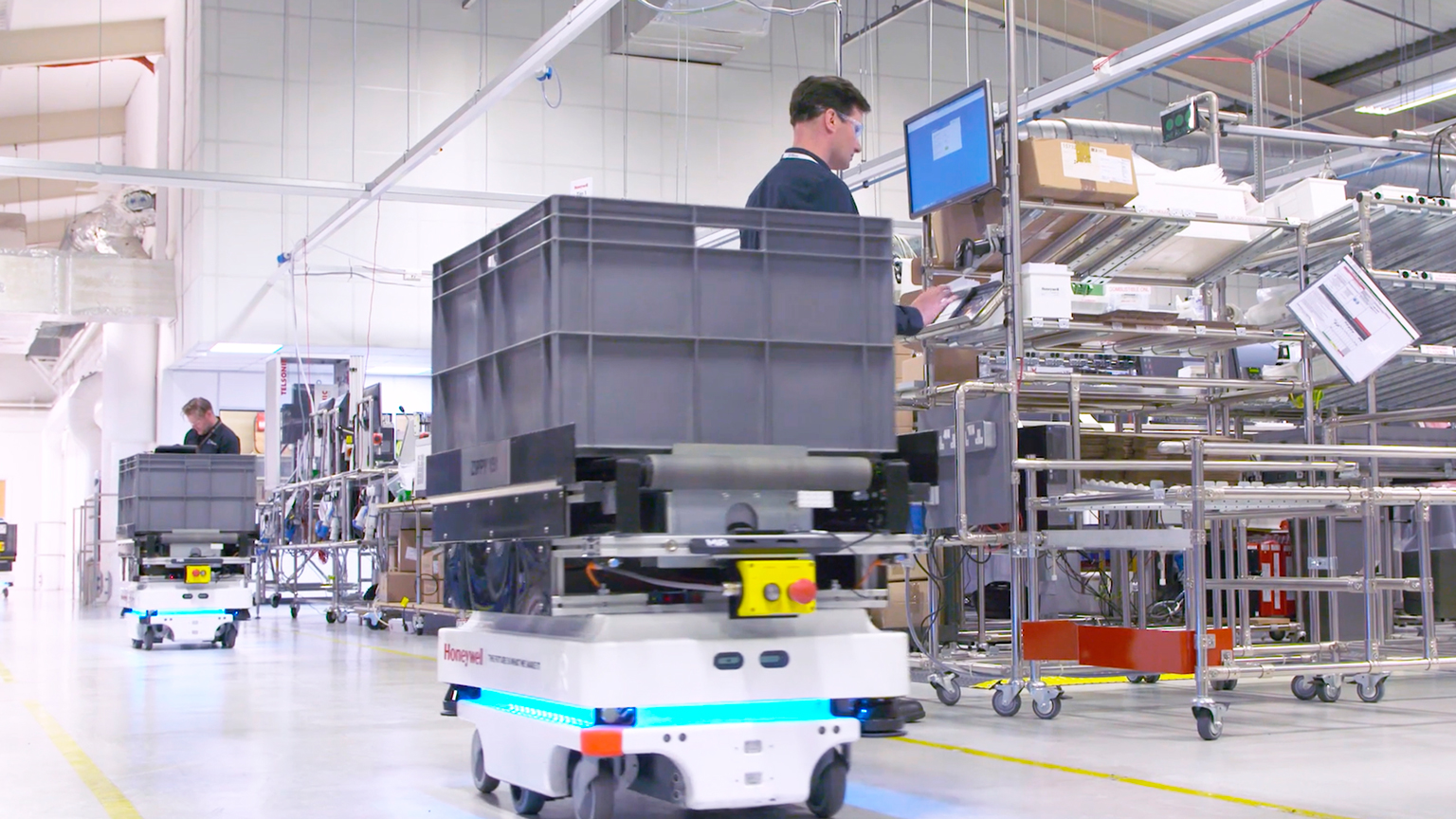

The use of autonomous mobile robots (AMRs) to transport materials through industrial buildings is booming. AMRs improve the efficiency of logistics while freeing employees from heavy, monotonous and low-value material-moving tasks. While these robots are designed to navigate safely around people, ongoing changes in the market can leave new users questioning how to ensure a safe installation. And the market’s fast growth has made it difficult for standards organizations to keep up and provide guidance.
If your company is looking into purchasing an AMR or fleet of AMRs, consider these safety tips:
1. Know what you’re buying. AMRs complete their given missions using sensors and software algorithms to maneuver through dynamic environments and avoid obstacles, with some AMRs recomputing their path on the fly. Extensive built-in safety mechanisms allow the robots to navigate collaboratively around human co-workers by slowing down, changing direction, or stopping to avoid collision. These safety features are key to the success of AMRs (the mobile robot itself) and AMR systems (the AMR, or fleet of AMRs—as well as charging stations, load transfer stations, and peripherals such as top modules that are mounted on the robots). Be sure to ask what safety features are included and whether there is an opportunity to add additional features as technology advances.
