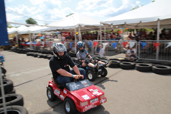

The red Fauxrrari from Team Section 67 passes another racer on the inside at one of the Power Racing Series events.
