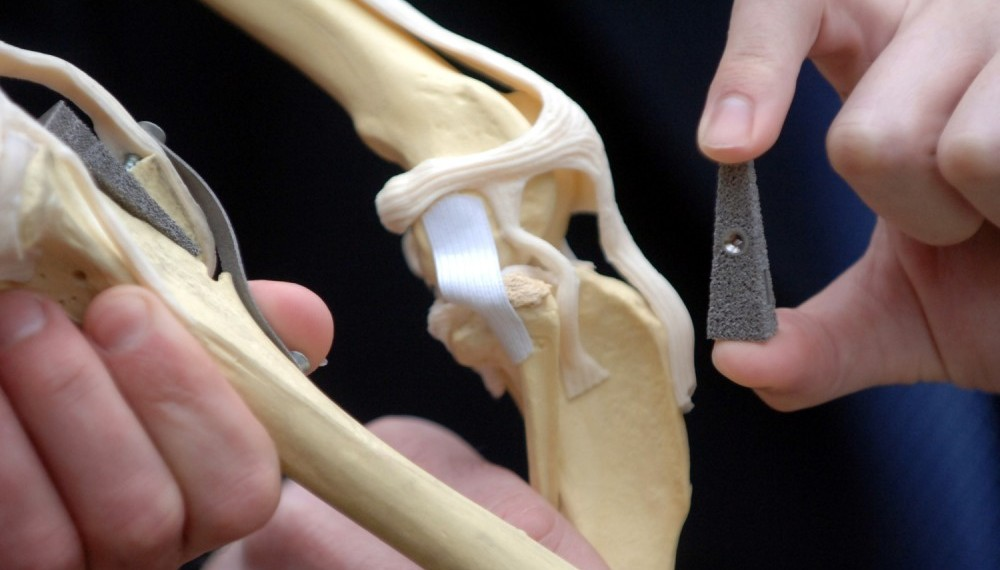

Researchers at North Carolina State University revealed test results of a heat-treated bioactive coating for use on polymer bone implants to improve bonding to surrounding bone, known as osseointegration. The implant is made of polyether ether ketone, or PEEK—a material that has found common use in bone implants because it has similar mechanical properties. It also resists degradation in aqueous and organic environments. But since it doesn’t bond to bone, the implant can be coated with a bonding material like hydroxyapatite (HA). In fact, a form of HA occurs naturally in bone, making up 70% of human bone by weight.
