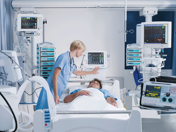

The modern hospital room can have several mounts holding control screens, displays, and equipment from the ceiling, walls, and carts. Good ergonomic design ensures they are all safe and easy to use, adjustable to a wide variety of nurses and health-care practitioners, and simple to clean.

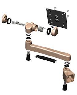

Constant-torque components in mounting applications can overcome several of these ergonomic hurdles. They apply friction that continuously resists motion, but only take a measured amount of force — a simple touch or gentle push — to permit movement.
Constant-torque joints in hinges and display mounts are based around hardened alloy shafts. The shafts are gripped by hardened-steel, torque-generating elements lubricated to generate a narrow range of torque for tens of thousands of motion cycles without additional lubrication or adjustment. The initial lubrication ensures low wear rates. With this construction, the joint or mount can reliably develop high torques in a limited space over the course of a lengthy service life. Properly designed and manufactured constant-torque hinges should last the life of the mount or hinge without maintenance.
