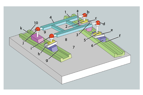

Kinematics of misalignment
To understand how a misalignment compensator works, one must understand the compensator’s kinematic characteristics as part of its gantry system. As an example, the accompanying 3D gantry diagram shows four supports. The bases of stages X1 (connected link 10) and X2 (link 1) are shown exaggeratedly misaligned in pitch, yaw, and roll with respect to each other as well as in flatness and parallelism. Assume the left X1 carriage (9) is the motorized master, and it has a spherical joint (j) that supports the Y stage (4). The opposite motorized right X2 stage (3) has one spherical joint (b) and one linear slide joint (c) which support the Y stage. The other X carriages (7 and 6) are idlers and also support the Y stage by a spherical joint and a linear slide.
3. The 3D model of a gantry shows the bases exaggeratedly misaligned in pitch, yaw, and roll.
Then counting the total number of degrees of freedom and subtracting the total number of constraints, the result is 1 degree of freedom. This means that only the master X axis can move independently and all other links will follow. In this case, if another independent motor drives the other X, an excessive load on the rails may result. This is an undesirable configuration for long Y stages and, therefore, engineers must make corrective changes to let the second X stage move independently from the first X stage.
Adding another degree of freedom to the system, such as for the X slave, means adding another degree of freedom to one of the joints. A common fix in such configurations lets one idler slide have a degree of freedom in the Z direction, for example, between spherical joints d and slide joint e.
The result will be a kinematic mount for the Y stage at joints b, j, and i, accommodating the 3D orientation of the stage 4 plane without any constraints. However, to prevent support of stage 4 at only three corner points, common practice is to add some compliance in the Z direction between joint d and slide e to take some of the load. In some cases the flexibility of link 4 may be sufficient; in other cases, a compliant Belleville washer may be used.
