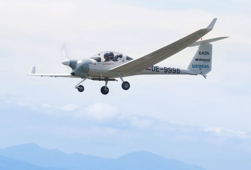

The DA36 E-Star flew for over an hour on its maiden flight.
Aerospace engineers at Siemens, Boca Raton, Fla., EADS, Herndon, Va., and Diamond Aircraft, London, Ont., Canada, are field-testing the DA36 E-Star, a plane that is a stepping-stone between gas power and a pure electric vehicle. The E-Star is the first aircraft to use electric power from a generator driven by a small gas engine. The two-seat, prop-driven plane’s serial-electric hybrid drive lets the aircraft take off quietly and cuts fuel consumption and emissions by up to 25%.
The DA36 E-Star’s motor generates around five times as much output per pound as conventional aviation drives.
The plane carries a relatively small Wankel rotary engine from Austro Engines, Germany. It spins a generator, which, in turn, powers a 70-kW electric motor that turns the prop. The 28.5-lb motor gets additional electricity for taking off and climbing from a battery. The battery recharges during cruising. Overall, the plane uses 80 kW of power on takeoff and 65 kW during cruise. A new Siemens drivetrain cuts the airplane’s weight by 220 lb, which significantly extends its range.
