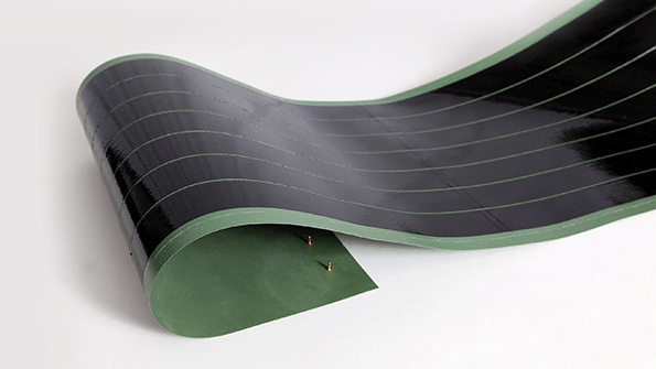

Engineers at Battelle Memorial Institute, Columbus, Ohio, have tested their HeatCoat, a device for keeping ice off the wings and control surfaces of drones. It consists of a carbon-nanotube coating that can be sprayed on or applied in flexible sheets. Sending electricity through the panel or coated area generates enough heat to prevent ice from forming and break free any ice that has formed. A controller monitors weather conditions and heater performance, ensuring power is only used when needed.
An anti-icing/de-icing device developed at the Battelle Memorial Institute uses carbon nanotubes powered by low levels of voltage to generate heat. The method can be deployed as panels (shown) or spray painted on as a coating.
