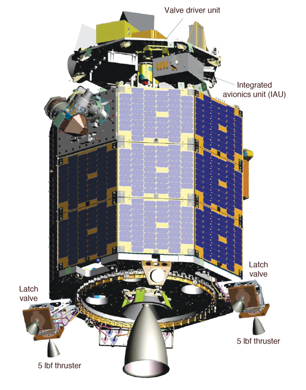

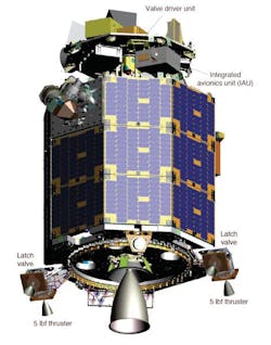

This NASA photo shows the LADEE’s two thrusters and avionics controller (called the IAU). A spectrometer on the LADEE scans the lunar atmosphere for atoms. So far, it’s detected three noble gases, tides of sodium and potassium, and regular dust clouds kicked up by a constant rain of meteoroids.

Part of LADEE’s life-extending components include an avionics controller that gathers data from a star tracker, an inertial-measurement unit, and sun sensors to drive the spacecraft into orbit positions through connections with power circuitry controlling the craft’s thruster valves. The 13.8-lb integrated avionics unit (IAU) is 9.90 x 8.26 x 4.68 in. It’s sturdy enough to withstand the extreme temperatures and radiation of space partly because engineers of Moog Inc., Huntsville, Ala., and Moog Broad Reach Engineering, Tempe, Ariz., designed its electronics with silicon coatings to resist ionization and eliminate the need for protective shields or metal enclosures.
Moog engineers designed LADEE’s four bipropellant 5-lbf thrusters 12 years ago. Each thruster has an injector and platinum-alloy combustion chamber to mix the hypergolic propellants (which ignite on contact, without an electric or thermal igniter). The combustion chamber resists oxidation and withstands temperatures exceeding 2,600°F. The injector design controls the fuel and oxidizer propellant impingement angles and velocities for a perfect mix.

LADEE’s integrated avionics unit (IAU) has multiple circuit boards and is powered by a solar-charged battery.
Two flow-control valves for LADEE meter propellants into the injectors. The torque-motor-actuated valves stay magnetically latched open (to allow flow of propellant to the thrusters) or closed (for a leakproof storage of the propellants). An electrical signal prompts valve actuation through a microswitch. The valves control the flow of both oxidizer and fuel to the thrusters with a single actuator, which reduces the component count and overall mass and cost.
LADEE’s 5.5-kg valve-driver unit, a stand-alone switch-extension platform from Moog measuring 5.6 x 7.9 x 3.5 in., controls and monitors the valves. The unit serially communicates commands and  status updates with the IAU.
Moog also made LADEE’s Spacecraft Energization and Power Interfacing (SEPIA) unit, a 1.5-lb safety power circuit that isolates the battery and solar-array power from LADEE until the spacecraft separates from the launch vehicle. It has extra connectors that let engineers power the spacecraft through umbilical cables during ground testing.
