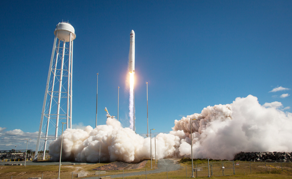

Antares

The 132-ft-tall Antares rocket, which was originally dubbed Taurus II, stands as tall as a 13-story building. It can put payloads weighing up to 11,000 lb into orbit and was constructed using proven components and technologies to be a cost-effective, relatively low-risk method of carrying commercial, science, and defense payloads in space.
