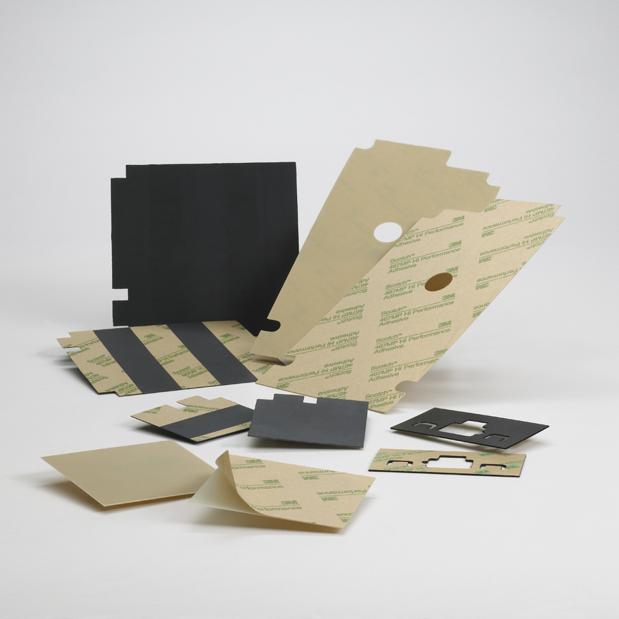

2. These die cut Lexan parts have been coated with an adhesive and will be used for electrical insulation.
Companies have teamed with adhesive firms to produce precut liners that address vibration and noise concerns. A recent trend is to have pre-impregnated adhesive in a matrix or thin films backing precut shapes. Pre-cut layered adhesive films can save time in assembly. “A vehicle can use thin laminated adhesives that are cut to size, which can free a designer to create a custom part that reduces weight, gives aesthetically pleasing results, and lets devices be thinner,” says Joe, senior account representative at 3M. “The industry trend across most markets is to go thin and lightweight; laminated adhesives accommodate for that challenge.”
