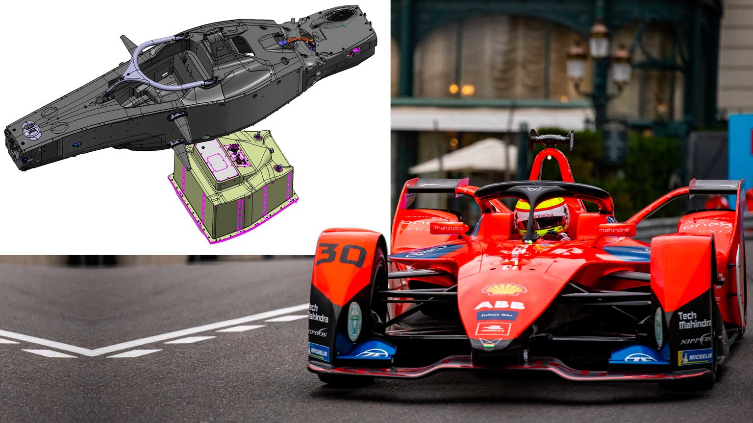

Mahindra photo collage
The Evolution of the Formula E Racecar

The body and frame is a carbon-fiber monocoque design with Kevlar honeycomb reinforcements. A carbon/aluminum “tub” protects the driver in case of crashes. Fairings on the front cut wind resistance and fins along the side provided crash protection; they are not aerodynamic structures. There are, however, front and rear carbon-fiber wings for generating downforce that keeps the car firmly on the road.
Spark created the chassis, one based on a standard racing chassis but redesigned to house a battery pack rather than an engine.

The battery pack, built by Williams Advanced Engineering, used lithium-ion pouch cells and weighed about 550 lb, according to Butler. It was said to have the storage capacity of about 300 laptop batteries or 4,000 mobile-phone batteries. To keep the battery pack cool, dielectric fluid circulated through the pack to remove heat. “And they have tested safety features that ensure that if the battery pack gets punctured or has thermal issues, it would not lead to runaways and fires.””

The most important change was the adaption of a new battery that could store 52 kWh of power. “The battery pack was improved by using newer cylindrical cells and higher voltages for less losses during races. The cooling was also improved,” says Butler.
The nearly doubling of the energy storage let teams complete races using only one car. The new battery also gave the cars more power, 250 kW. This translated into top speeds of 174 mph.
Contributing to the bump in speed was that the cars were lighter. “Materials used everywhere in the car were of higher quality or delivered more performance per unit mass, whether that was power electronics, casings, transmission parts, motor or cooling,” explains Butler. “Everything was reworked from the ground-up.”
For safety the league mandated the installation and use of halos. It’s a titanium rollbar of sorts that surrounds the top of the cockpit. If the car rolls over, it can withstand 12 tons of force and protect the driver from large flying objects such as wheels. Similar devices have been used on Indy cars since 2020.

To keep fans apprised, the halo protection device has an LED embedded in it that changes color. If it glows blue, the car is in attack mode; if it glows magenta, the driver has activated fanboost.
“Mahindra moved strongly into the Gen2 era with an all-new powertrain kit, as dictated by the regulations, and started strongly,” says Butler. “As is now nearly ubiquitous in Formula E cars, we continued using a transverse motor and reduction gearbox with no change gears. Now into the fourth and final season of GEN 2, we can still regularly make a strong showing despite the increasing strength of the opposition.”
