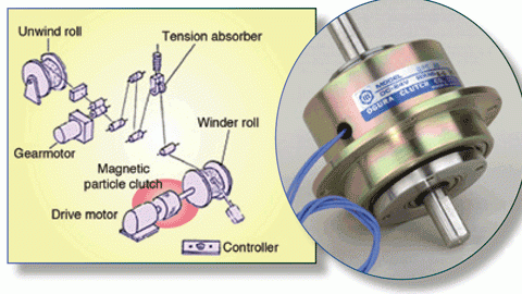

Consider how a plant might control the rewind tension when transferring wire from one large roll to smaller rolls: As wire is rewound onto the smaller rolls, a dancer arm measures the diameter of wire applied. This is fed back into the controller, which controls the voltage going into a clutch, keeping a constant tension on the wire as it is rewound. Here, magnetic particle clutches are often used. Why?
Magnetic particle clutches are suitable for drag and winding applications because their voltage-to-torque relationship is almost linear, so accurate control is easily maintained.

Elsewhere, permanent-magnet hysteresis brakes control wire tension for coil-winding machines. In one setup using these components, wire is set on a spool on the ground. (The normal tendency for wire coming off a spool is to uncoil, so there is a bit of slack in the line.) Wire goes up to a pulley mounted on a shaft going through the brake. In some setups, the wire is also wrapped around the pulley twice, for a tight connection. Then the wire goes across an idler pulley and down to the coil winder. As the wire is drawn from the brake to the coil winder, it is drawn at a constant tension, regardless of coil winder speed.
Permanent magnet hysteresis brakes are suitable here, because many small coils do not change that much in diameter, so a constant-torque brake allows for a slight tapper tension on the end of the coil wind. Certain units deliver constant torque regardless of the slip speed so wire tension is constant even at high coil-winder speed. Adjustable brake units also accommodate different wire sizes, and in some cases, marks on the unit are simply set to the wire tension required.
