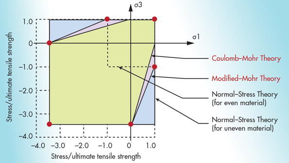

Figure 2 shows the stresses some that can be covered by static loading situations. Notice how a design must be less conservative (cover a larger area of stress) when dealing with brittle material—the line between Coulomb-Mohr’s versus modified Mohr’s. In addition, for uneven (materials that are stronger in compression than tension), using one of these methods over the normal-stress theory can allow for a more efficient design.
2. Note that the positive sides of the axes are tension and the negative sides are compression.
The principle stresses calculated by the failure theory (represented in Fig. 2 as σ1 and σ3) must fall within the area covered by the theory selected, not the opposite way around. Do not select the failure theory that covers the area with the stresses. This is because the different theories represent the behavior of the materials under that loading scenario.
