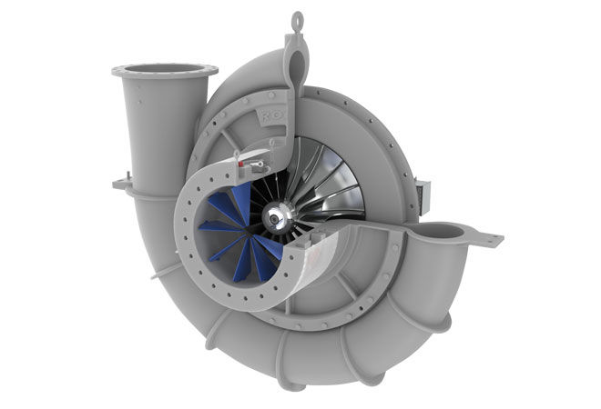

Negative-displacement air compressors or dynamic compressors are typically centrifugal compressors. Using a spinning impeller, a centrifugal force is generated to accelerate and decelerate captured air, which causes it to be pressurized. To control the capacity of a centrifugal compressor, the inlet guide vanes are adjustable. Closing the guide vanes reduces the volumetric flow and capacity.
3. Centrifugal compressors are oil free with the running gears and mechanical parts separated from the air by shaft seals and vents. (Image courtesy of Direct Industry)
