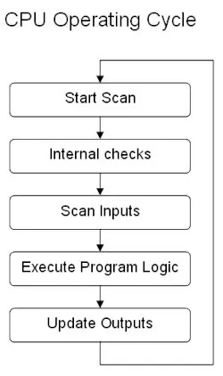

3. A CPU operating cycle includes the following steps: a) start scan; b) internal checks; c) scan inputs; d) execute program logic; and e) update outputs. The program repeats with the updated outputs.
