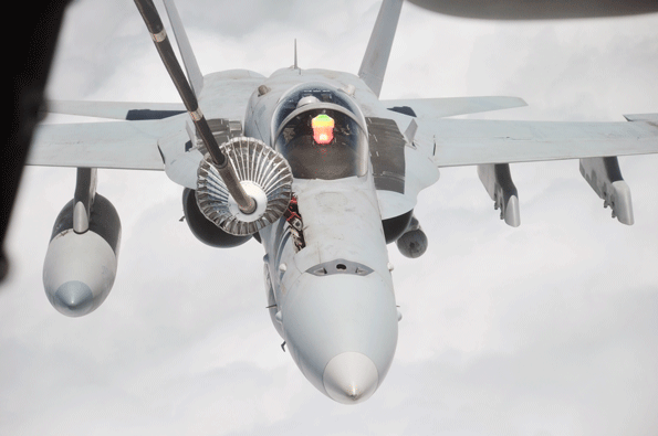

U.S. Navy fighter jets such as the F-18 can refuel in flight by extending a probe and “drinking” from a basketlike drogue on a tanker aircraft such as a KC-10. The operation is dangerous, and the equipment is subject to impact forces during engagement, not to mention the brutal environment of altitudes to 50,000 ft.

Here, a U.S. Navy F/A-18 Hornet aircraft refuels from an Air Force KC-10 Extender aircraft from the 908th Expeditionary Air Refueling Squadron.
