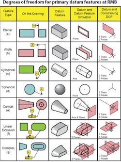

The degrees-of-freedom concept has been introduced recognizing that a part has six degrees of freedom, three translations, and three rotations. These degrees of freedom must be constrained to mathematically apply or measure geometric tolerances. The degrees of freedom approach in establishing a datum-reference frame is not new, it was first introduced in the ASME Y14.5.1-1994 standard and is now a staple of the new ASME Y14.5-2009 standard.
A degrees-of-freedom table has been added to the datum section. This table identifies primary datum features regardless of material boundary. The table describes the theoretical succession of events beginning with the identification of a datum feature on a drawing, its related datum feature simulator, the datum it establishes, and the degrees of freedom it constrains. This enhancement allows any feature to become a datum feature.
As a result of allowing any feature to become a datum feature, datum-feature modifiers have been expanded using new datum-feature modifier terms such as Maximum Material Boundary (MMB), Least Material Boundary (LMB), and Regardless of Material Boundary (RMB). These new terms replace the datum feature modifiers Maximum Material Condition (MMC), Least Material Condition (LMC), and Regardless of Feature Size (RFS).
The terms MMC, LMC and RFS were always confusing in the past when applied to datum features. Because even though they were referenced at MMC or LMC, they really applied at virtual condition. The term virtual condition is still used in the new standard but only for features and not datum features. The new datum-modifier terms MMB, LMB, and RMB provide a much-clearer definition of the boundary established by related datum features. It is also necessary now that irregular features of size can be recognized as datum features. There are examples in the standard explaining how to calculate these boundaries.
