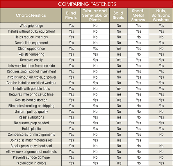

Choosing the Right Fastener
There are no simple rules for determining which are the best fasteners for a given thin-walled application. But answering the following eight questions can give design teams solid grounds for a good decision.
  1. After original assembly, will the joint ever be taken apart and put back together for maintenance or access to other parts? If so, tapping screws or nuts and bolts are almost certainly the best choices.
  2. Will the joint experience shock or vibrations? If so, either conventional or blind rivers are probably needed, and tapping screws are eliminated.
  3. What strength is needed? Nuts and bolts provide the most tensile and shear strength, followed in order of decreasing strength by conventional rivets, tapping screws, and blind rivets. Nuts and bolts are also best at resisting twisting. If the joint material is thin or soft, and if resistance to loosening is a requirement, blind rivets should be used.
  4. Can joint components be brought to an assembly machine, or is it necessary to bring the tool to the work? If the tools must go to the work, blind rivets are likely the best choice.
  5. Is the back of the joint accessible? If so, conventional rivets and nuts and bolts are acceptable. If not, blind rivets or tapping screws must be used. And how far is the fastener’s hole from the edge of the joint? Distances of more than 6 to 12 inches probably preclude the use of conventional riveting machines.
  6. If the application calls for a blind fastener, how much backup space is available? Less than 0.225 in. of space dictates a blind rivet; more space allows use of tapping screws.
  7. Can any of the fastener candidates have special features that might be important for the application? For example, some blind rivets and screws are self-sealing, and most rivets can be prefinished to blend with joint colors.
  8. If all other factors are equal, which fastener leads to the lowest in-place cost? In some instances, the decision is simple. For example, if a second worker is needed to buck a conventional rivet from the back, then installing a blind rivet will cost less. Other applications required in-depth analysis. For example, the capital investment needed to set up an automated riveting machine may not be justified for short runs.
