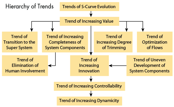

The figure below (Hierarchy of Trends) illustrates the hierarchical nature of these trends and the top level categories. For each of these, there are typically several sub-trends that describe slightly different directions. The bottom line, according to those who use it, is that the way your product is likely to evolve over time is predictable. If you understand these trends, you can anticipate what form the next generation of your product is likely to take. So, as the technology to realize this next generation becomes available (or you create it), you should be able to stay a step ahead of your competition.
As an example, one of the most important trends in product evolution is the “Trend of Increasing Value.” For this purpose, value is defined as being equal to (total functionality, F) / (total cost, C). The trend states that an engineering system evolves overtime so that its value always increases.
