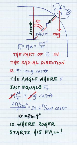

What is the angle θ at which Roger begins to leave the surface? Let's find out.
Review the problem: Badger Banter.
As if air travel weren't bad enough, Roger the Badger is passed through the X-ray machine at security.
The hinges on his carrier come open, leaving the poor dear traveling on a conveyor heading for a swift downward curve.
θ = 86.4° ... how humiliating.
