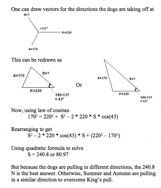

The angle between King’s and Summer’s leashes is 137°. With what force does Summer pull to counterbalance that of the other beasts?
Review the problem: Gone to the dogs.
This one can be solved in a few ways, but don't get tripped up:
