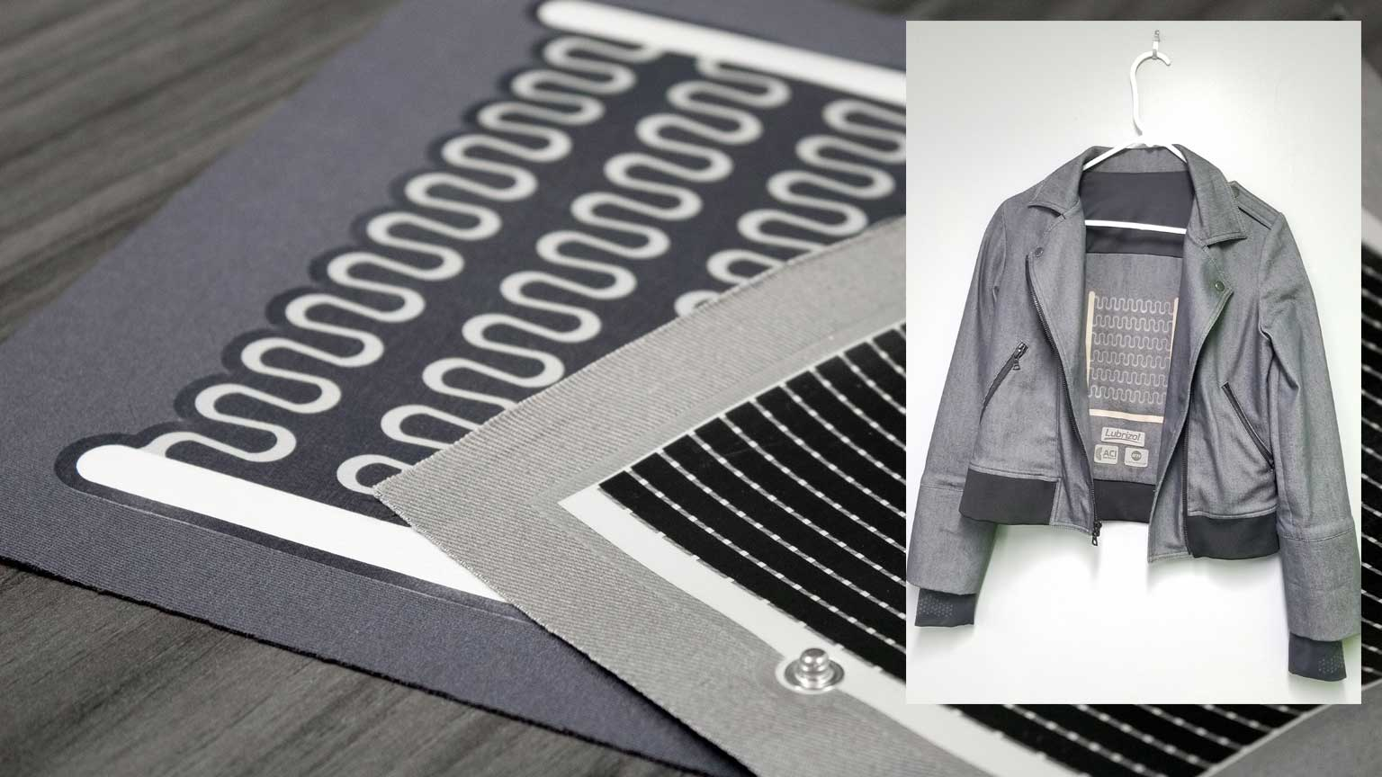

Flexible printed heaters are a relatively new technology drawing the attention of product designers worldwide. They are being used in innovative thermal applications in industries including automotive, medical, athletics, aerospace, defense and utilities.

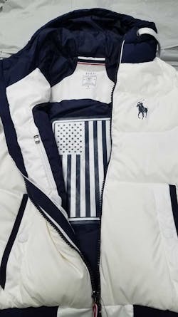

In the 2018 Winter Olympics, for example, the jackets designed by Ralph Lauren and worn by Team USA had built-in flexible printed heaters designed with help from Butler Technologies, Inc. Engineers at Butler overcame several technological hurdles while they were developing and fine-tuning the flexible heaters.
For instance, they struggled with establishing consistent print thickness for the conductive inks. The variability in the ink thickness and resistance caused inconsistencies in the heater’s performance. Another struggle was using repeatable screen-making processes and maintaining a consistent screen press set-up. This is critical to the heater’s operation.
The team also had a hard time accurately measuring the dry film thickness and electrical resistance during production runs. This is crucial in manufacturing consistent heaters.

Flexible printed heaters rely on a range of conductive and resistive inks with a positive temperature coefficient (PTC) that lets them act as heating elements. PTC materials increase their electrical resistance when their temperatures are raised. In terms of printed heaters, this means that as the temperature increases, the electrical resistance of the heating element also increases, ultimately limiting current flow. The inks are deposited on flexible substrates, such as thermoplastic polyurethanes (TPU), polyimide (PI), polyester (PET) and Kapton RS conductive film using screen printing.
Through their pattern and deposition, the inks let engineers tailor the flexible heaters to meet specified operating parameters based on the application. The heaters can have one or more resistive elements, like a printed trace or wire, and each element then converts electricity into heat.
At some companies, these heaters are made using screen printing. Conductive busbars and resistive heating elements are printed onto a substrate. An insulating layer is typically added to protect the printed circuit. The protective layer can be printed to be decorative or carry branding graphics such as logos or operating instructions. An adhesive layer added to the opposite side simplifies mounting the heater in the final application. The multi-layer heater is then laser- or die-cut into its final shape.
The heaters can be manufactured in high volumes using print processes such as flatbed screens, rotary screens and roll-to-roll techniques,  depending on the type of heater and materials used.

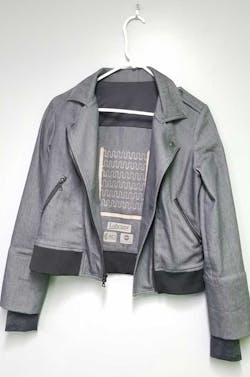

Flexible printed heaters are ideal for wearables. Prior to flexible heaters, heating for clothing and medical use was done with metal wires running through the inner layers of fabric. The rigid and bulky wires that could be uncomfortable for prolonged use. Compared to those older wearable heaters, printed ones are much more comfortable and flexible.
For wearables, Butler makes heaters with typical power densities of 0.025 watts/in.2. So, a 5-x 5-in. heater will have 25 in.2 and consume 6.25 W. In contrast, a flexible heater with a polyester substrate for industrial or automotive applications typically have power densities ranging from 1.2 to 1.9 W/in.2. For the same 25 sq. in. heater mentioned previously, the power required is between 30 and 48 W.
The wearable heaters from Butler Technologies are considered reusable because they are meant to last for several uses. For example, once a wearable printed heater is installed into a garment, it will typically withstand 50 to 100 washes before its performance begins to diminish. This can be considered a long time, especially if you take into account the number of times you would wash the article of clothing each year.
For the best fit and comfort, printed heaters are commonly made using thermoplastic polyurethane (TPU), a thin, flexible rubber-like film. It is soft, conformable and stretchable material. These characteristics make the heaters comfortable in wearables and lets the person wearing the self-heating clothing move freely.
TPU-based heaters have a hot-melt adhesive side which lets them be easily attached to fabrics using standard heat transfer equipment that many garment manufacturers and decorators already use. Since the printed heaters are self-regulating and powered by portable rechargeable battery, there is little or no need for additional hardware and software design, or a power cord.
